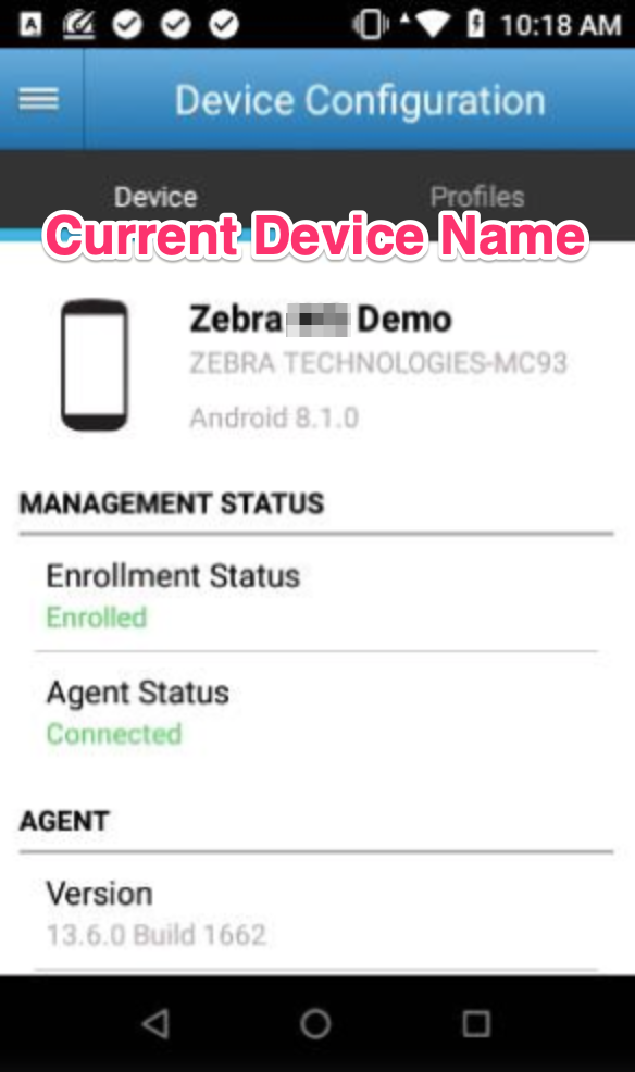

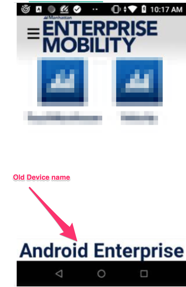

The Device Name updates immediately within the MobiControl Agent when its renamed but the update is not reflected in the lockdown:

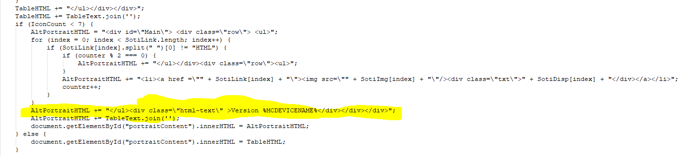

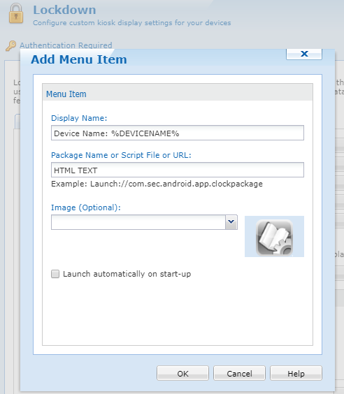

I was waiting to reply until I had touched base with SOTI to open a case on this.  The issue was with "how" we were displaying the variable.  In our case we had a Dynamic lockdown screen provided to us by our VAR.
For example, if we wanted to display a text field, it was inserted as a Menu Item:

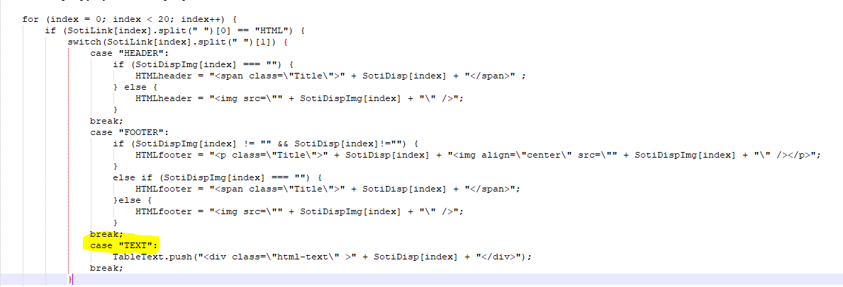

The HTML file has a script to dynamically build an HTML Table:
This wasn't automatically updating, so after working with a SOTI tech we determined it wasn't updating unless we inserted the variable outside of this table that was being built, presumably when the profile was assigned and never updating until the profile was further updated.
I ended up throwing it in the script but outside of the for loop that generates the table and was able to get it to update as soon as the change was made in the console.
