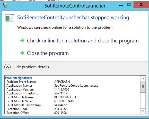

I can't connect with Legacy remote control. This problem exists in server operating systems. No problem with client operating systems.
Problem signature:
Problem Event Name: APPCRASH
Application Name: SotiRemoteControlLauncher.exe
Application Version: 14.1.8.1000
Application Timestamp: 5b771145
Fault Module Name: KERNELBASE.dll
Fault Module Version: 6.3.9600.17415
Fault Module Timestamp: 54504ade
Exception Code: e0434352
Exception Offset: 00014598
OS Version: 6.3.9600.2.0.0.272.7
Locale ID: 1033
Additional Information 1: 5861
Additional Information 2: 5861822e1919d7c014bbb064c64908b2
Additional Information 3: a10f
Additional Information 4: a10ff7d2bb2516fdc753f9c34fc3b069

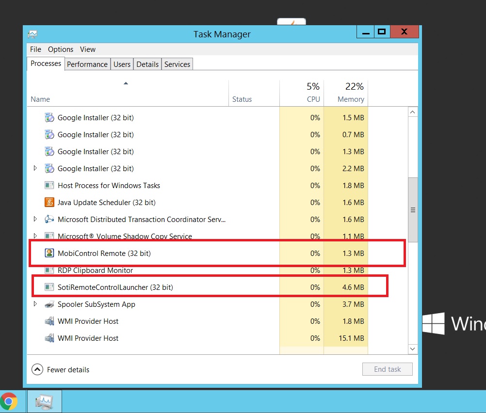

But nothing happens when I want to connect to the mobile device. No warning and application does not open,

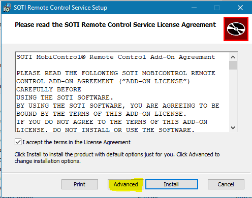

Can you try re-installing the SOTI Remote Controller and when prompted too, click on "Advanced" and make sure you install for "Install for all users".
Let us know if this helps.

I have tried this solution 5 times. I have installed Windows 2012 and 2016 for testing. I have tried the same process in the newly installed operating systems, but the result is the same. Windows 10 is also no problem. But Windows 2012 and 2016 also have problems.

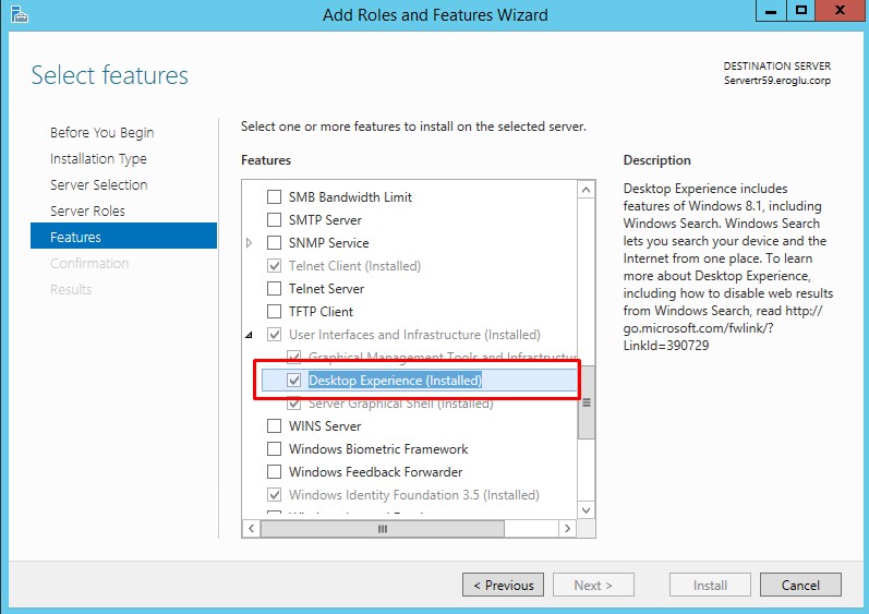

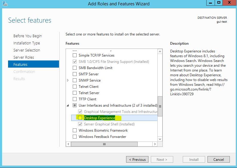

Please check if the feature 'Desktop Experience' is installed or not on the server.
If it's not installed, Install it and reboot the server. Then try to run the RC session using the Legacy Plugin.
Let us know if this helped.
CS
Cem Sahin
This feature is already installed. But the problem continues
