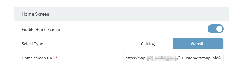

For some reason, the weburl doesn't use the custom attribute.
I've added the attribute in the global settings tab and gave it a value(scanner_1005) in my device group.
Added the weburl like this https://sap/%CustomAttr:saplink%
It doesn't load the weburl with the value of the attribute.
Edit: Screenshot attached.
Edit2:changed screenshot
I've also tried to just use the customattribut but that also doesn't work

Hi Raymond
I'm using Version: 15.6.1.1048
and soti Surf 15.6.0 Build 7
doesn't seem to be getting the value.
attached a screenshot
EDIT: Send to Device is active
