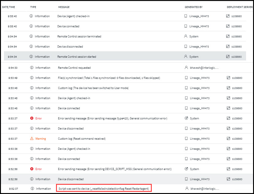

I can't even control the device at all, the RC session window opens, then closes and then the device shows as offline. It will come back online after a few seconds.
I have tried using legacy and web-based with the same result = cant remote into device. Web-based returned the error as noted in the subject.

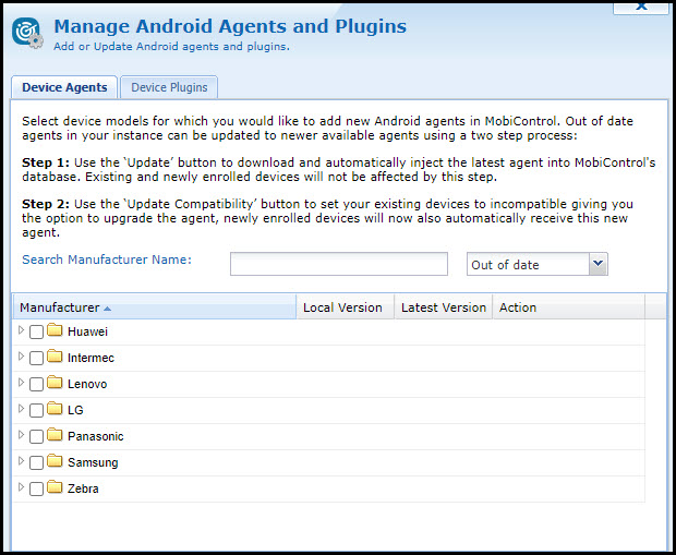

Also as a general note, some devices require a plugin. Double-check if yours need it via https://docs.soti.net/mobicontrolagentdownloads.

Reset RC script:   If this is the script to use _resetfailedrcdetectionflag Reset Restartagent, then it didnt make a difference.
Also, do I need to install the device plugin separately if the agents and plugins are up to date for both the Manufacturer and Android Enterprise????
