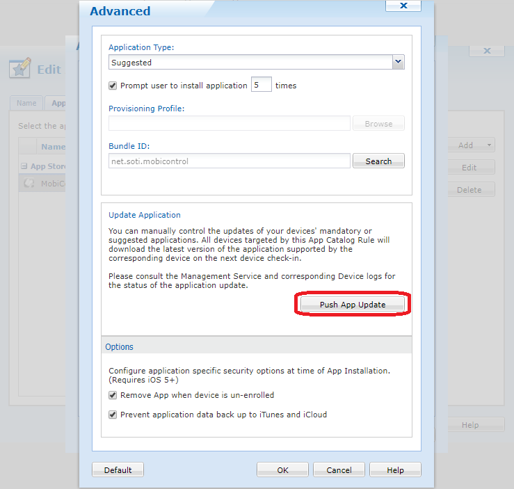

MobiControl Versions 14.0.2+ or 13.4.0.4167+
The process to push a regular or VPP App Store application update to iOS devices requires an administrator to use the button named “Push App Update” in the Advanced settings of an application in the App Catalog Rule as shown below:
Upon confirming this action, MobiControl performs the following actions for all devices that are targeted by that App Catalog Rule and whose application was installed by MobiControl (ie. the application status is Managed):
  • persistent device commands to update the application are generated
  • devices are asked to check-in
Since all device commands issued in this process are persistent, unlike the previous implementation, this new process does not require a device to check in within 24 hours of this administrative action.  More importantly, in the case that the application update is not successfully installed on a device, because the user of a device rejects the update for instance, the administrator can request MobiControl to push application updates to iOS devices again without having to wait for a new version of the application to be published in the App Store.
Please note that repeated invocation of the "Push App Update" is highly discouraged because each invocation requests all devices to update their applications even if their application is up-to-date and therefore doing so can result in very high data usage rates for your iOS devices.  To provide some protection against accidental repeated invocations, MobiControl will not request a device to update its application if the device command to do so is already queued for that device.
