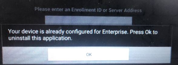

Device enroll via android enterprise upgrade os 9 to 10 but after upgrade mobicontrol error "Your device is already configured for Enterprise. Please ok to uninstall this application" and can doing anything I don't know android 10 conflict mobicontrol agent.

Exactly what steps did you take to enrol your Android 10 device?  Please provide screenshot(s) of the device screen at different stages.

I can enroll device android 10 normally but after upgrade 9 to 10 show below picture.
