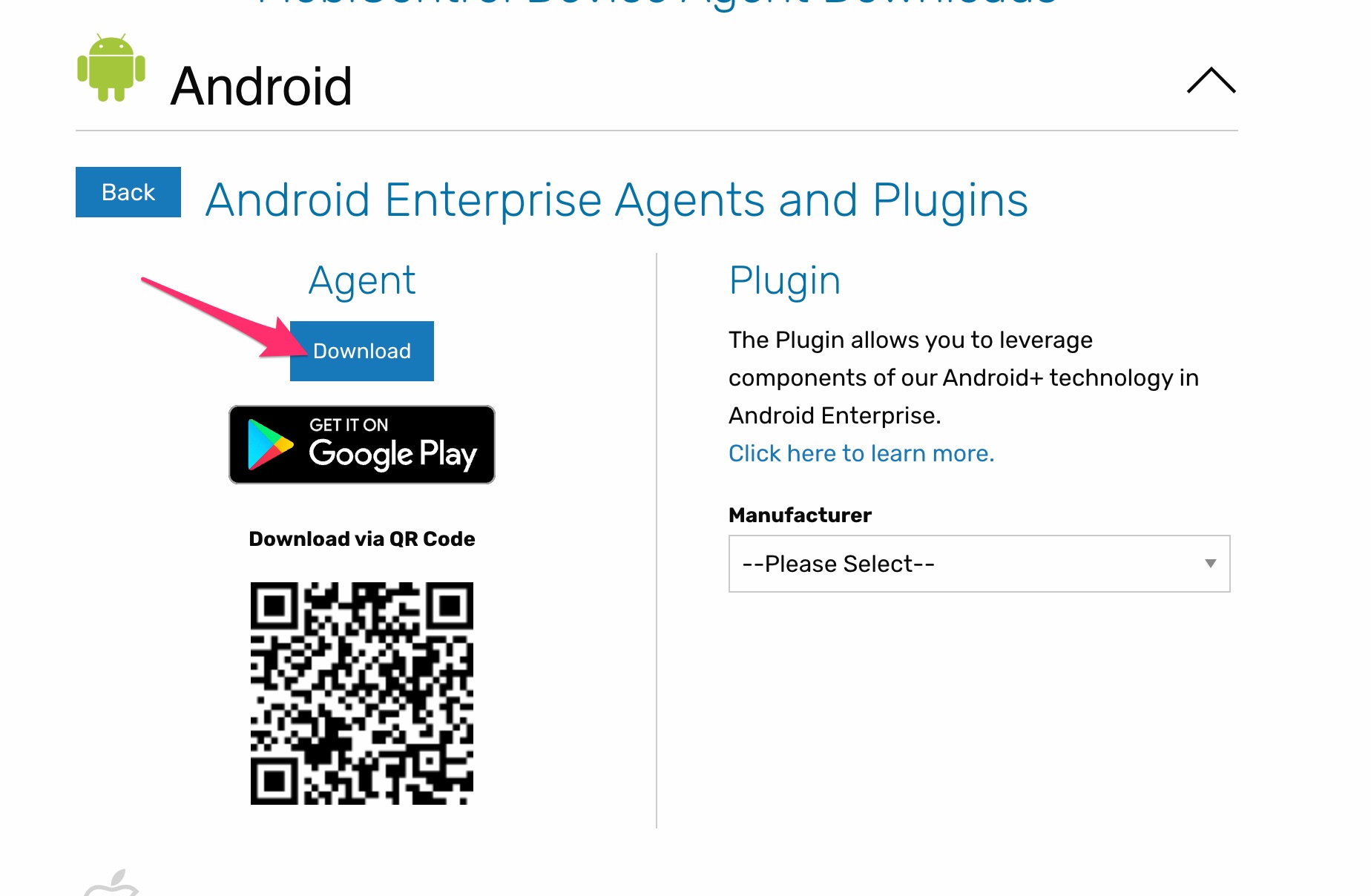

If your device has access to http://soti.net/apk/ae2 you can use this as the download path in stage now.
This should always have the latest Android Enterprise Agent.

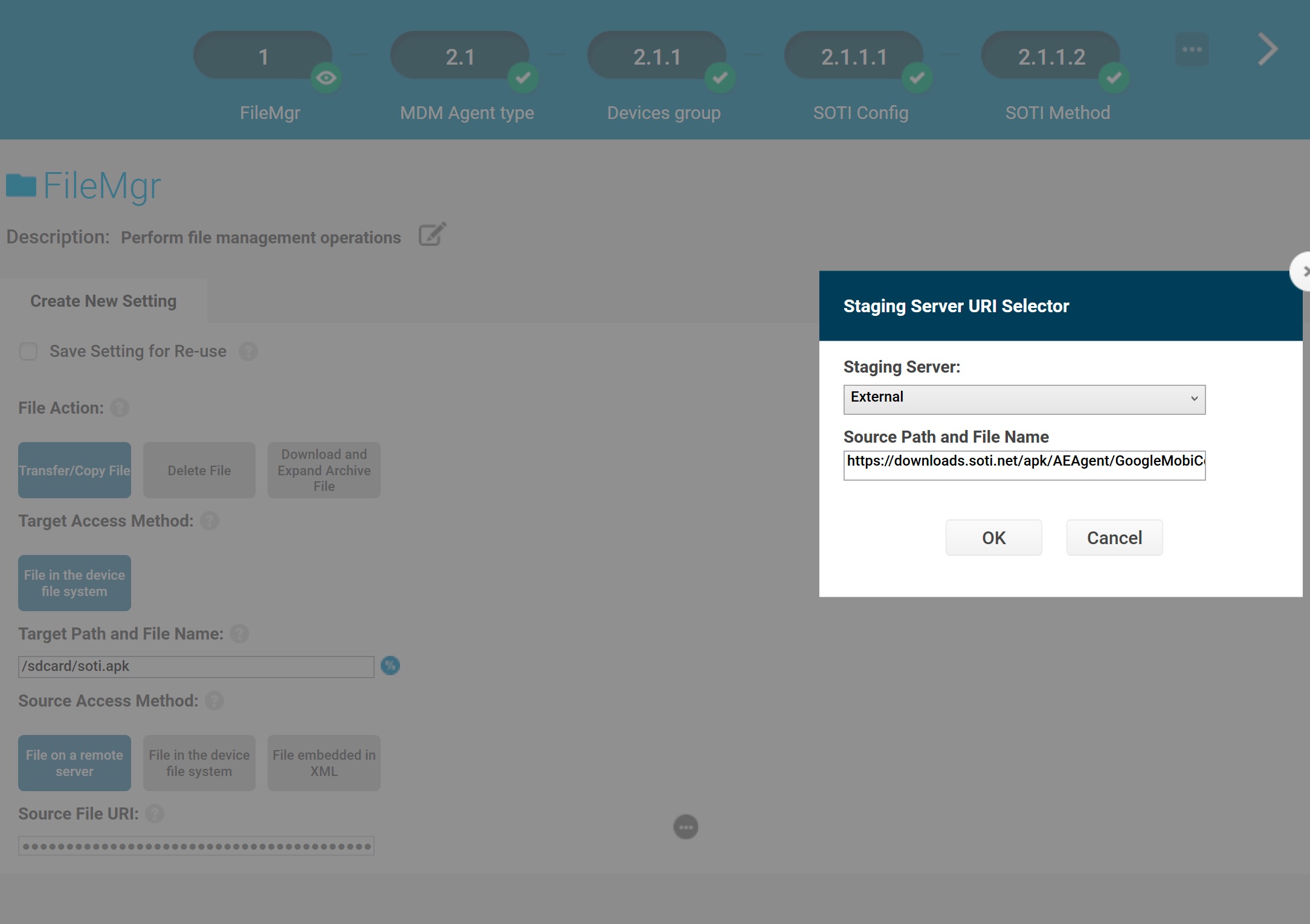

This is what I'm looking for but I can't find a place on stage now to put that link!
I'm using the "Enroll in an MDM" wizard, but in the download APP section, it seems I need to put a target path and file name on the device! I think I should not need to target the .APK in my device, if the name change it will not work after!

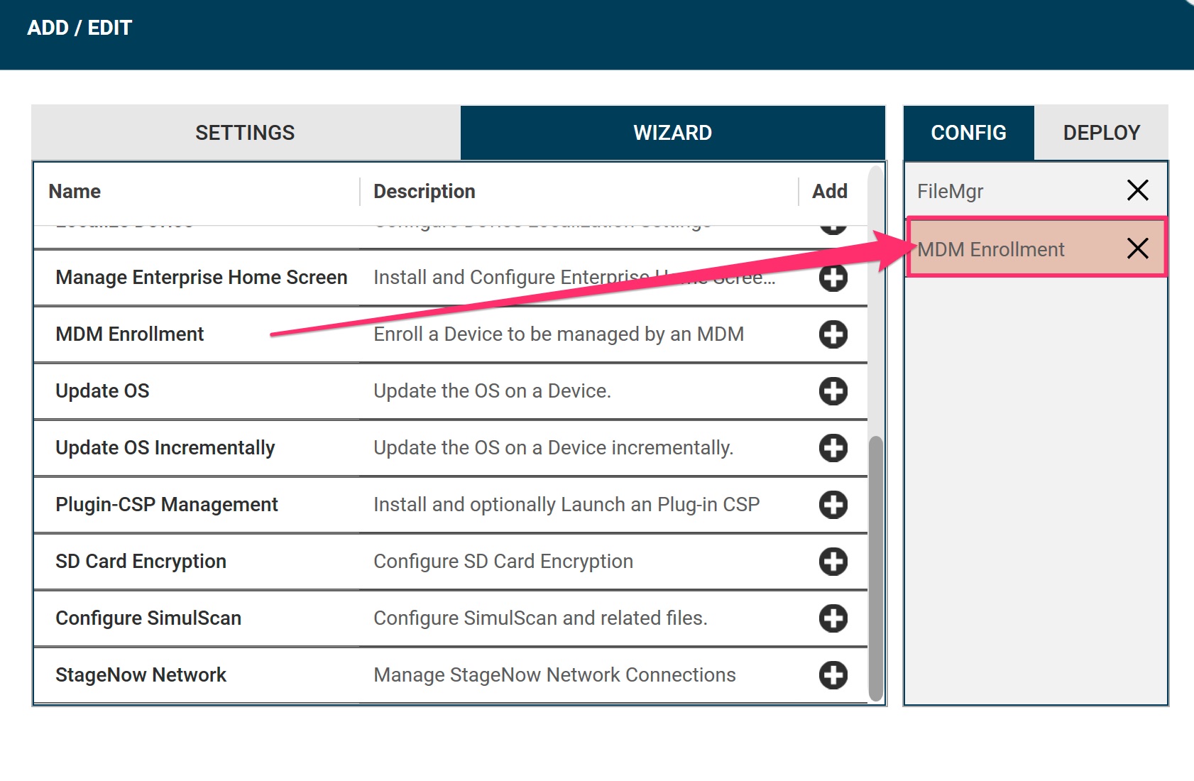

I don't use that Wizard I use Xpert mode and the combo a File Mgr with the MDM Enrollment Wizard from the Xpert mode options. You can link to the APK download in the File Mgr options

I personally don't like to use this link because it can result in different agents installed on your devices if they are staged and enrolled at different times. I prefer using the static link as I have more control over which version is being used at any given point in time.
