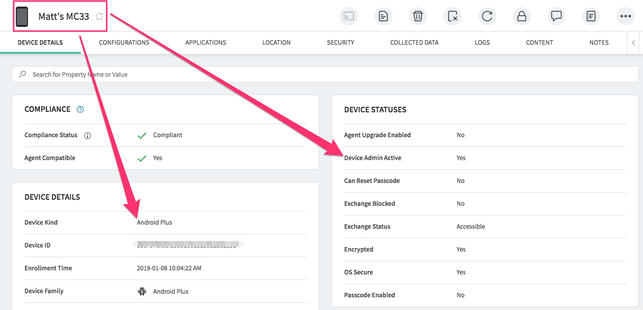

I have an MC33 enrolled in my test 14.x environment using Android+(DA). The device is AOSP running Nougat. I have had some trouble enrolling any of the Zebra Oreo builds using DA but that may be due to Zebra no longer signing the OEM agent moving forward in order to push us towards AEDO. If your device is running O I would suggest downgrading it to N and attempting to enroll again to see if that is the issue.

I don't quite remember but it looks to be on 13.6.0.1257 which is newer than the version that my server distributes so I likely pulled it from the OEM downloads.

Do you have the APK and can you share it?
I tried every Zebra agent in the OEM portal. The closest one to your version is 13.6.0.1476, but it doesn't work for me.

Thanks a lot Matt.
It works!!
