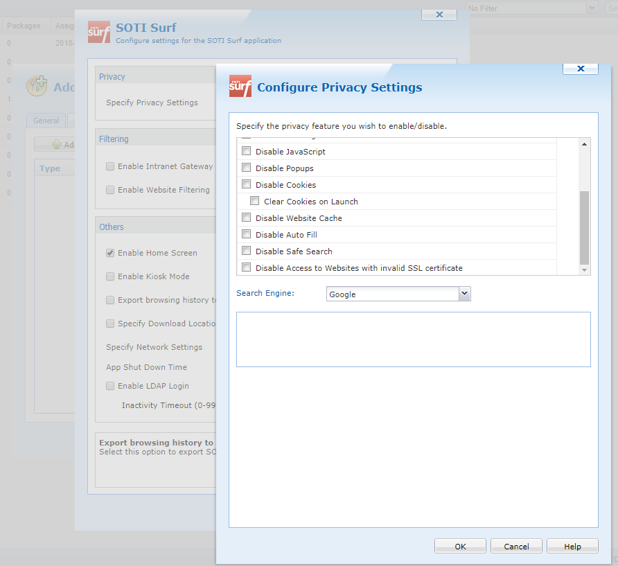

Hi Oliver,
Raymond is correct in many of his assessments of the web browsers that are available and that SOT Surf usually can provide the most options for more granular control of the browsing experience.
Based on your response however it seems that chrome/webkit (default browser) has been able to somewhat accommodate your requirements.
I have attached a screenshot of the Features/ Security options that are available in SOTI Surf please clarify if you have tried using them and what the outcome was.
Surf Privacy
