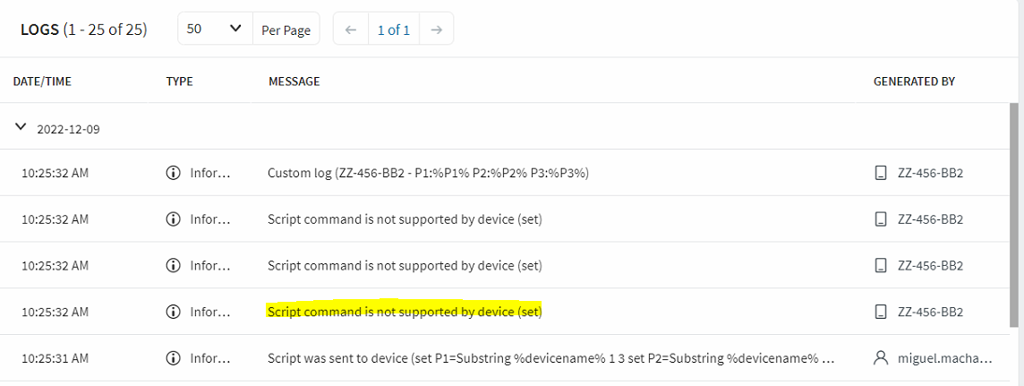

Hello Raymond, I junt found where I can see log message.
I have this message so substring don't work.

The legacy script commands mentioned in the previous post I sent out last midnight may not be supported by recent device agents any more.
This morning, I successfully put together the  4-5 lines of javascript  (e.g.  the mobicontrol.device class and string function)  required to do the same parsing & new name formation tasks as the legacy script does.  Unfortunately, the final function (or javascript class method) to do the device renaming seems to be missing based on the latest online javascript API's documentation.
So, the remaining option left for such smart bulk renaming operation is likely be doing it with REST API calls, which required many fold of lines of codes to perform  the task.
