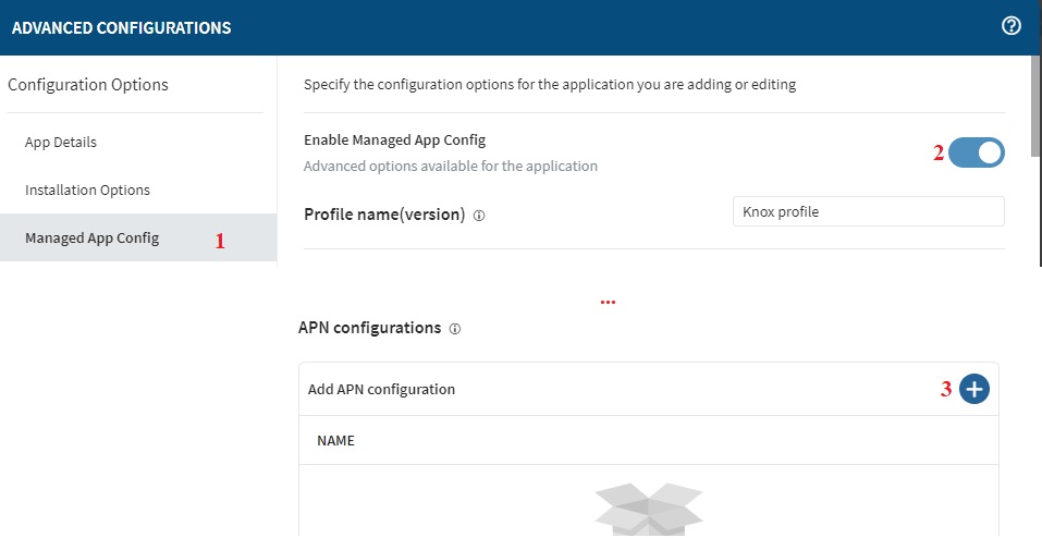

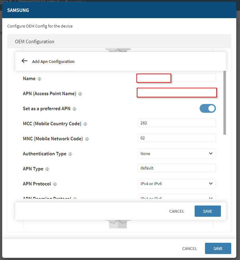

Use the Samsung OEM Config App "Knox Service Plugin" or if you are already on Mobicontrol 15.6.1, then you can use the profile "OEM Config: Samsung" directly.
LC
Leon Callsen
3 years ago
Hi Rafael, thanks for your answer. Unfortunately nothing happens on my device when I use the Knox Service Plugin. I am on 15.6.0
Is there anything which I am missing?
RS
Rafael Schäfer
3 years ago
So, even you entered the information into the managed app configuration?

As you can see in version 15.6.0 it's already possible to use the profile but nothing happens on the device. Same for the managed playstore config.
