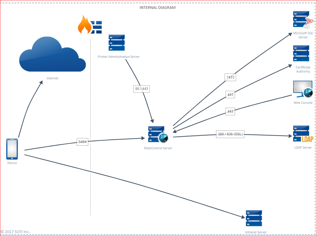

I would like to inform you that it is not recommended to change the port :443 because it is used for many services as per the diagram below.
In order to define the custom port we would like know if you are using 443 for some other purpose. What type of type of devices are you using ,Mobicontrol version and configurations. Therefore, It is strongly advised to create a support case (click here) and work with SOTI engineer who can examine your environment according to type of devices as if right process would not be followed  then it would have adverse consequences.
