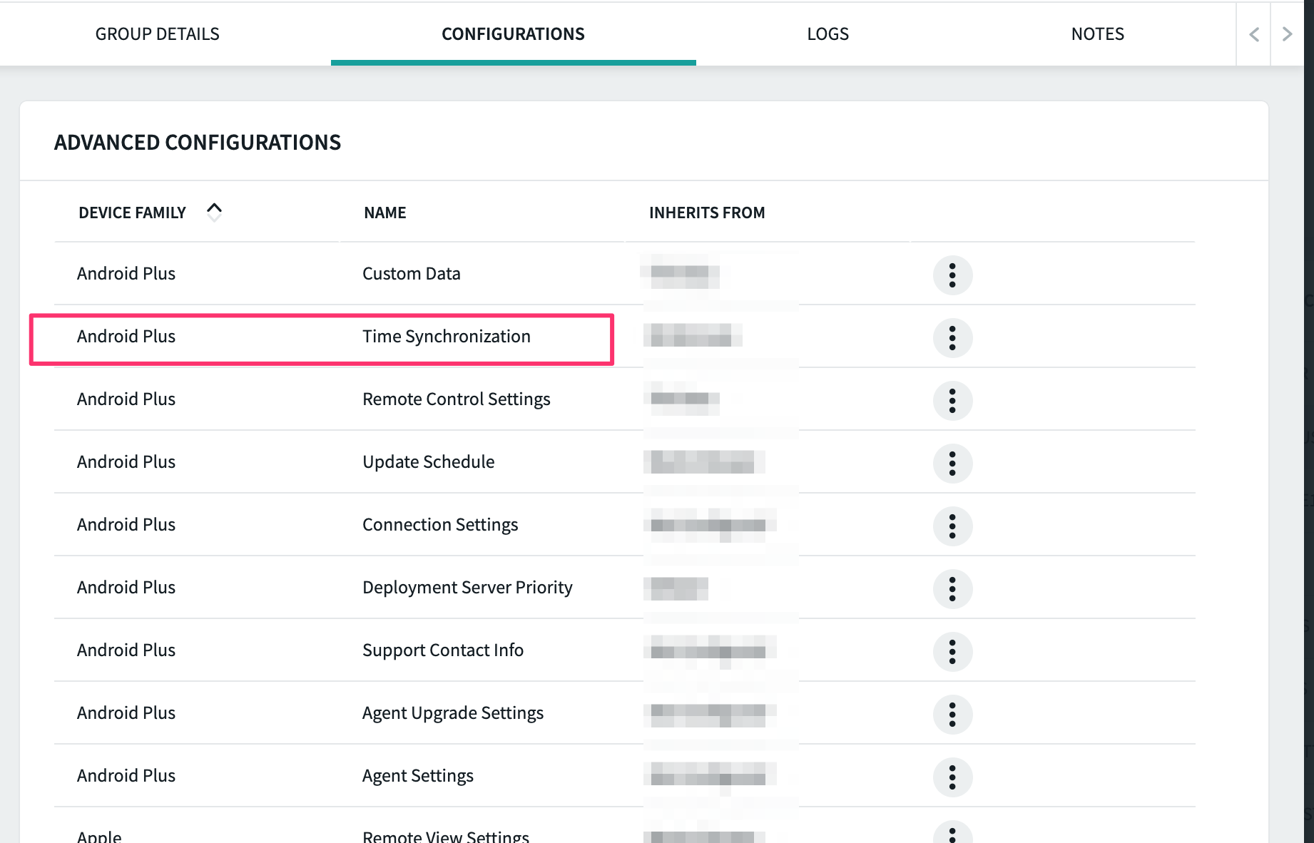

Does the Time Synchronization policy not apply to Android Enterprise devices? I'm becoming increasingly frustrated by the lack of clear separation of capabilities between AE and Android Plus within the documentation and the SOTI console itself. These Advanced Configurations are listed under the Android Plus device family but Custom Data works on Android Enterprise while Time Synchronization doesn't? Is there anyway to know what scripts and Advanced Configurations do and do not work in AE without manually guessing and checking? I would expect that given that the Help documentation is a centralized web page that it could be updated more frequently.
According to the on-line release note, time synchronization is supported on Android Enterprise devices via AE plug-ins from MobiControl v14.2.2 onwards.   I did test to verify that on some of my test devices.  However, I don't know if it applies to all existing AE plug-ins downloadable from the Soti official web site as of today.
Thanks RC, I'm using Zebra Android devices running Oreo with the latest AE plugin.

Time Synchronization never worked for me since day 1 (that'd be starting with MobiControl 14.0.0). Since updating the device agents to 1.3.6.0.1662 (or the prior build) I noticed the clocks were finally starting to synchronize on 14.2.2. Finally.

I was told by the SOTI engineer that I work with that the issue is that Zebra won't sign a new Plugin file that would support Time Sync.
I am with you as with my frustration with both Zebra and SOTI. We purchased the TC77 that comes with Oero of course Zebra and SOTI decided that the device would only be supported with AE. The number of AE support features is sorely lacking for the Zebra TC77.
