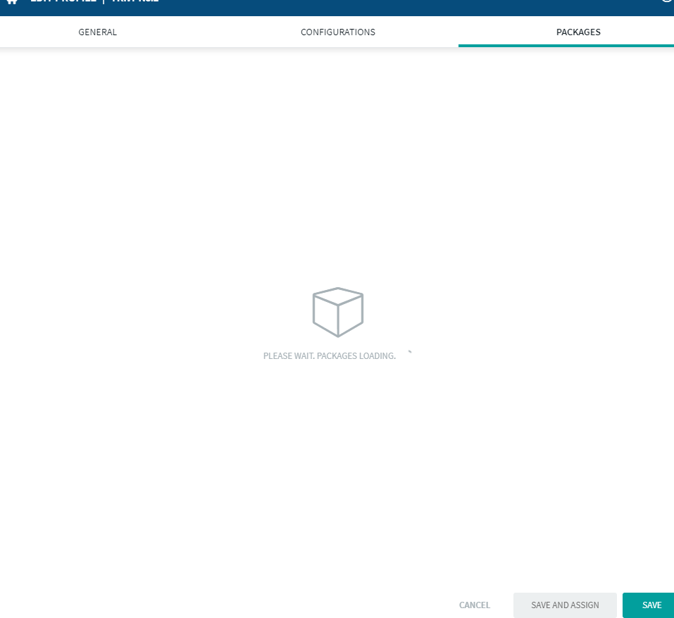

Hi all,
I have been testing v15.0.2 and I was about to migrate from 14.1 to 15.0.2 when all of a sudden, this happened. Neither I from web console, nor the devices via mobicontrol installation can get the packages. There are no logs that I can relate to anything similar to this. Any ideas?

Hi there, 15.0.2 was installed without any errors. I found a workaround, removed the profiles and did a server reboot. After that Packages were acting normal. Previous reboots without removing the profiles did not work. Gotta remove the profiles.
