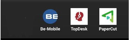

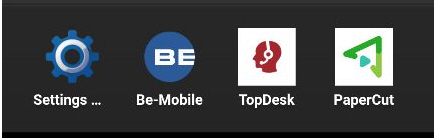

With have 4 App
I would like to remove the first app, but leave the other apps in the same place.
so that it looks like this and I can add another app later.
