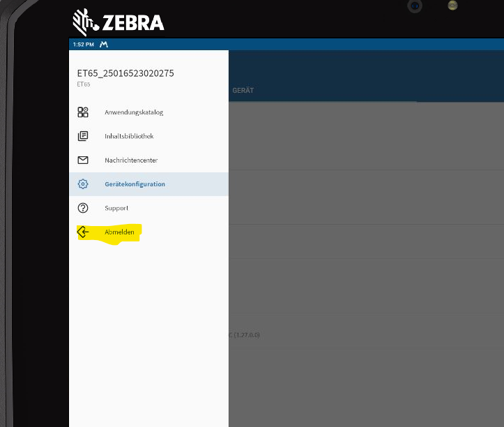

Hi all,
we have set a new shared device group and it is needed that the Devices will log off the user automatically on restart / reboot the device.
Gives there any option to set it in Mobicontrol? (standard logout scheduler after a period or on inactivity is not practical)
Gives a command or intend to app to force logoff via script?
Gives an MX / Stagenow / XML command?
Background is, we fear that users will forget their device password and will no longer be able to unlock their device and log themselves out. This way, users have the option to help themselves, restart their device, log in again, and create a new password.
Server is MC 2024.1.1.1058, Agent is 2025.0.2.1045, Device ET65
Thanks Henry

HI Robert,
yes, the option to initiate a script via task scheduler we know and use it to remove device password and clean cache on reboot, but the question is: Which command causes the user to be logged out?
the Mobicontrol agent app is responsible for login/logout but to wipe these app does not work to force logout user ... "wipeapplication net.soti.mobicontrol.androidwork"
