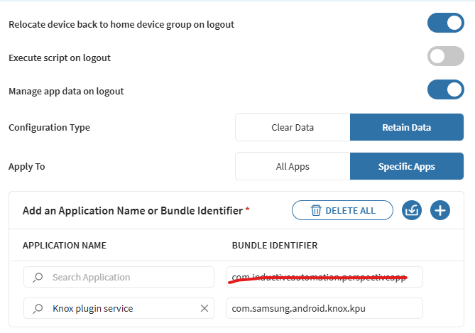

Sup mate,
I had the same issue with Samsung devices, so if you are using them too, this will be usefull to you.
On log-out select to "retain data" for "com.samsung.android.knox.kpu".
To verify if this case. You would be receive error message while logging out on the bottom of the screen and also if you push action to the device "Troubleshoot shared device" it will actually fix the issue for once. (at least in my case)

Hi Tomas
Currently I have it setup to Clear Data > Specific apps
The Knox Plugin Service data should not be clearing as it is not listed as a specific app to be cleared.
Its setup this way because I want to make sure the Office365 apps such as Outlook, Teams, Edge are all cleared on signout. Ready for the next user when they sign in. I also have a few other apps to clear such as their Training app etc.
Unless the knox plugin serivce is being cleared anyway? not sure, maybe I can get SOTI to check in the logs.

For me it was getting cleared anyway, even though it was not defined anywhere.
