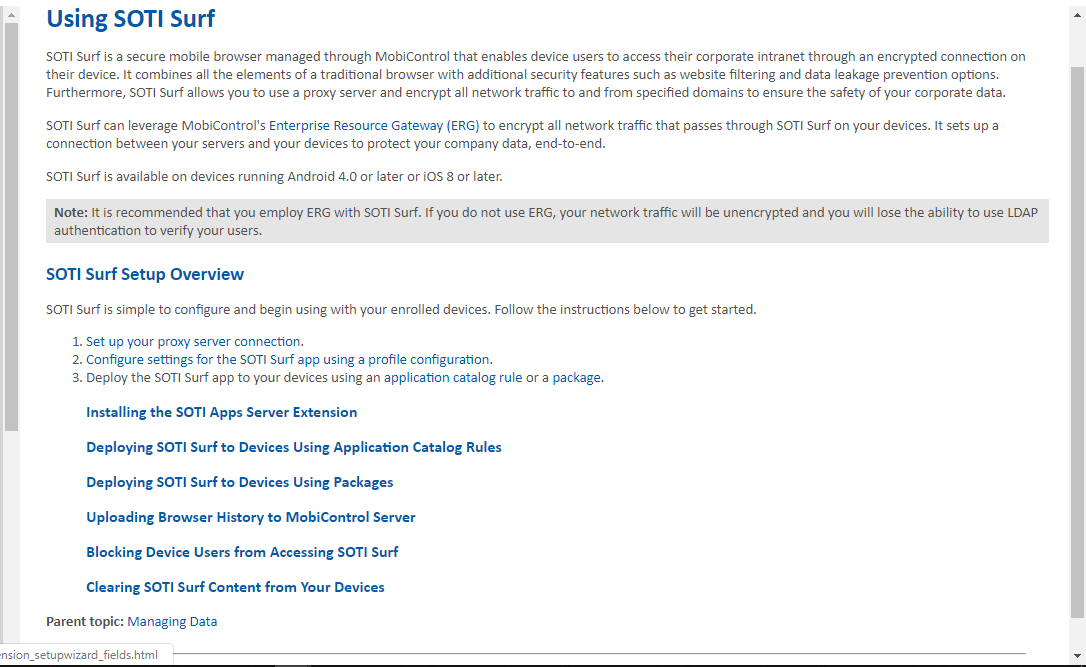

Raymond has brought up a good way of doing a "base test" to confirm that your setup of LDAP is working as expected.
Here is a screenshot and link to the help file assistance when configuring SOTI SURF.
As much as I would like to assume the ERG was installed I do not see any mention of this, by name, in your post.  Please note the highlighted section in the following image.   I have included a link for quick reference afterwards.
https://www.soti.net/mc/help/v14.1/en/console/configurations/profiles/configurations/categories/sotiapps/surf.html
