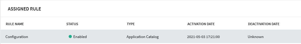

But when looking on devices, I see that there is still "Application Catalog Rules"
Those are making echoes with the last App policie we made.
Application Catalog is not possible to access anymore, so basically, how could i remove this one?!

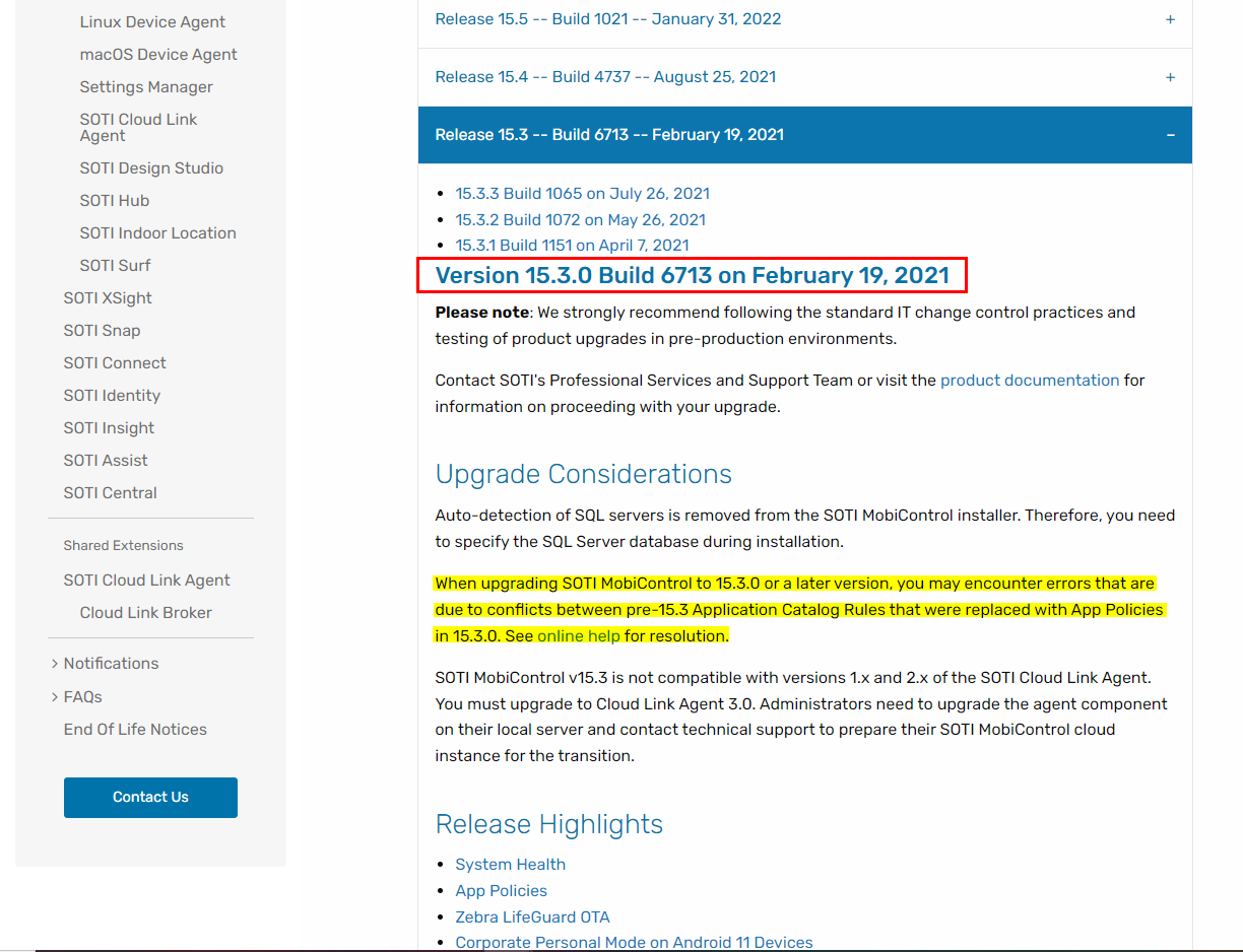

Yes, that is correct, Application Catalog became App Policy on February 19, 2021 (See Release Notes, link below)

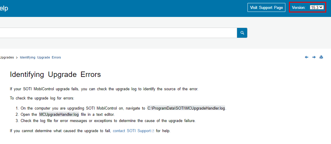

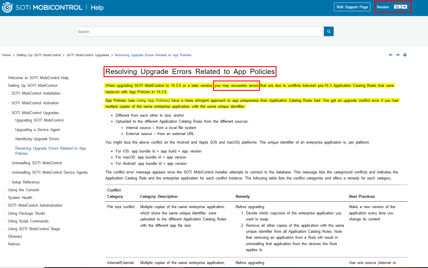

As per SOTI MobiControl Help page for version 15.3 and onward, here are two articles regarding Upgrade Errors that may explain some errors regarding App policies. They may not apply to yours.
For your information:
For further investigation, as you suggested, please raise a ticket with Technical Support.
