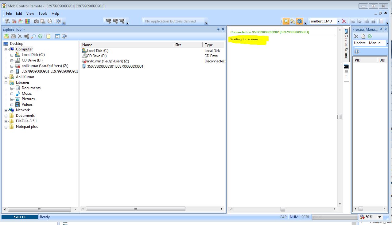

we have one new device Sumsung J8 . remote control is not working . other activities are working fine like  package push . file copy
please find screen for your reference

The points made by Raymond are a great place to start when troubleshooting remote issues.   Your screenshot shows that you are in the remote control and the pop up for the device is not opening, or the device is not connecting.
In addition to the requested information, can you verify that the browser is not blocking this from opening VIA a virus scanner or popup blocker on the workstation please?
