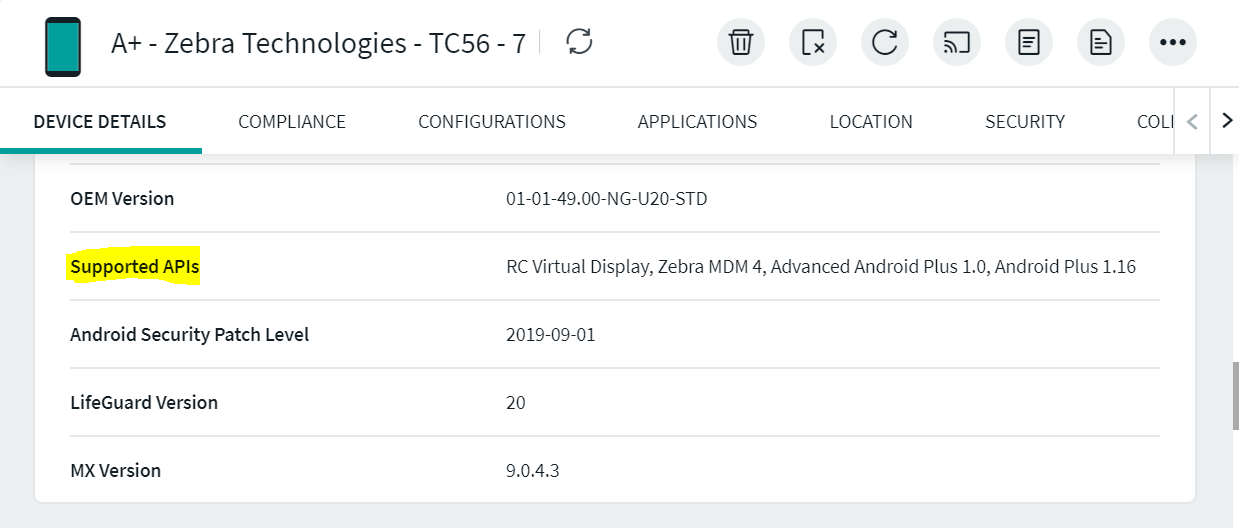

If the RC fails again, please share the picture of supported APIs available for that device.

To add to this topic, you could automate the execution of the script in order to fix this type of issue. Typically the Supported API row on an affected device will reflect "RC Error". As a result of that, you could set up a profile with Task Scheduler to execute the fix along with the Filter Criteria feature. See the below as reference:
Note - Ensure within Task Scheduler you set it to execute once.
