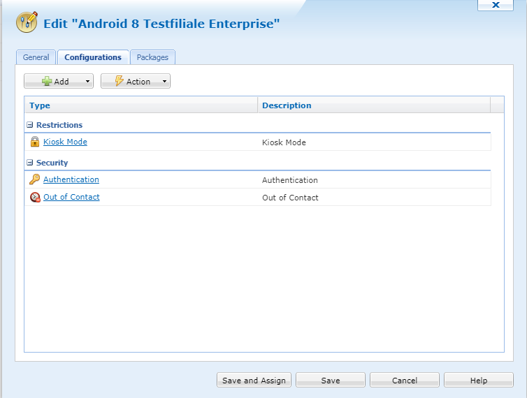

It works now for both devices. It seem that you have to NOT set some Settings in the profile konfiguration.
The only ones we now use are:
I removed following Configurations:
  • Application Run Control
  • Feature Control
  • Settings Manager
One or more seem to make a problem with RC+. Don't tested step by step removed all of them because the other device is using only those rules too (without "Out of Contact").

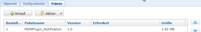

Have you downloaded and deployed the MobiControl Android-Enterprise plug-in for Zebra to your device yet?
R
Rafael

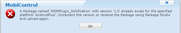

Hi, where to get this plug-in? Or is it the MDM Plugin Notification?
https://docs.soti.net/mobicontrolagentdownloads/
Click "Android Enterprise Agent and Plugins", and then choose the manufacturer in the Plugin section on the right.
R
Rafael
As I mentioned we already use it:

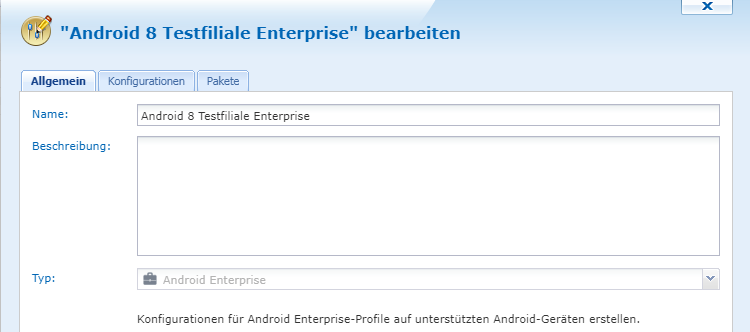

Remember that you'll need to create new profiles for Android enterprise devices, anything 8.0 and up. Create a new profile and select Type "Android Enterprise", assign the same MDM plugin package.
R
Rafael

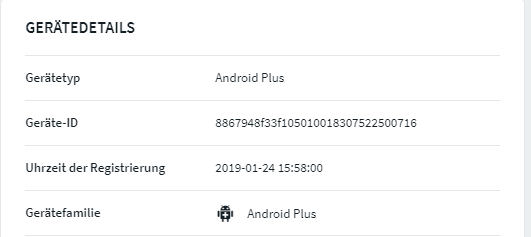

The Profile is Android Enterprise:
But if we take a look at the device:
and it looks same on the Android 8 device on which we are able to use Remote Control and the other one on which we only are able to use Remote View.

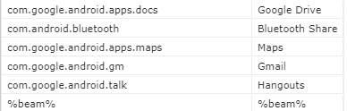

Out of the three, I believe the most likely problematic profile payload is application-run-control.  What apps did you include?
R
Rafael
