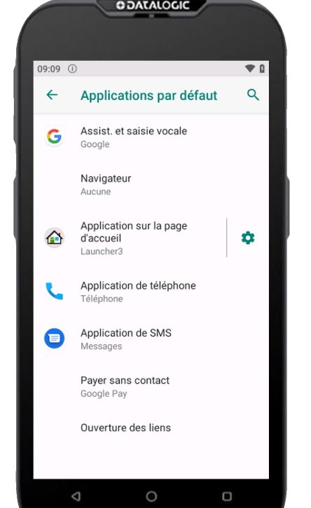

We currently got around 300 Memor 10 registred to Mobicontrol and want to make them use Soti Surf as default browser.

I tried
But it always finish as partially installed.
Maybe related with the fact that i Need to push it through app policies , cause if not some website seems to respond strangely.
Working better when chrome is up to date.

Hi ,
I just gave another try.
In fact, Default Browser doesn't even change..
Tried every script on the page without success.

I have discussed this with our dev team and please note below are some limitations for Android Enterprise:
- User will not be able to override the default browser app if there is some default browser selected after installation of Surf or any other browser.
- User will be able to override the default browser app if there is some default browser selected before installation of Surf or any other browser
- Device settings will not display Surf as its default browser even after it is set as default browser.
You may also try manually change the default browser from Chrome to Surf and do a test.
