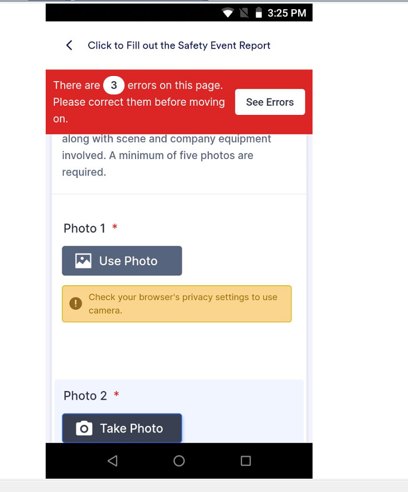

I'm running into a strange issue where opening a standard web link URL from a kiosk lockdown in SOTI Surf results in the error "Check your browser's privacy settings to use camera".
This is on Android Zebra TC56J on OS 8.1.0 and agent version  2024.1.4.1149. SOTI server is 2024.0.0.1075 on premises.

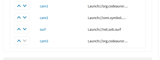

Anyway, I have added all instances of any installed camera apps to the lockdown screen (just not in the XML layout so they don't show as shortcuts) in addition to SOTI Surf itself. The site and all subdomains of it are whitelisted. I cannot find any setting that would prevent the camera from working. Does anyone have some ideas to check? Thanks!
All camera apps and surf added to home screen:
