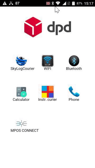

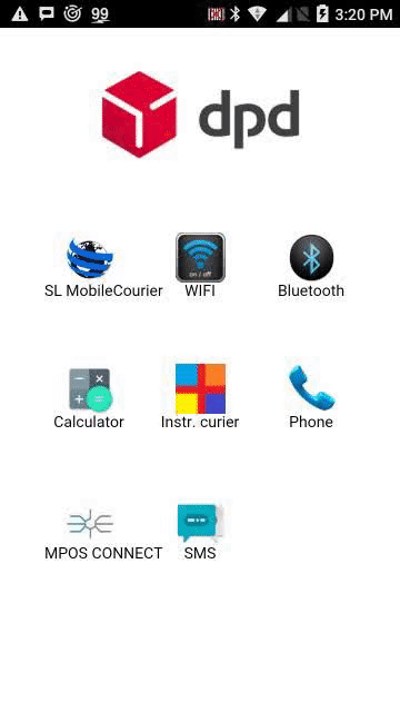

We have around 900 M3 SM10 devices which running Android 5.1.1 (some of them with an older firmware and most of them with latest firmware) and we have this situation: on devices with older firmware I have access to Bluetooth - More Settings option and on the newer devices I don't.
Please see below examples:
  • M3 SM10 with older firmware (agent version 13.3.1.1010)
  • M3 SM10 with newer version of firmware (agent version 14.1.1.1003)
I want to be able to access Bluetooth - More Settings on devices with agent 14.1.1.1003 like on devices with 13.3.1.1010
Both devices has the same settings in Lockdown and Feature Control. I don't know what to check more.
