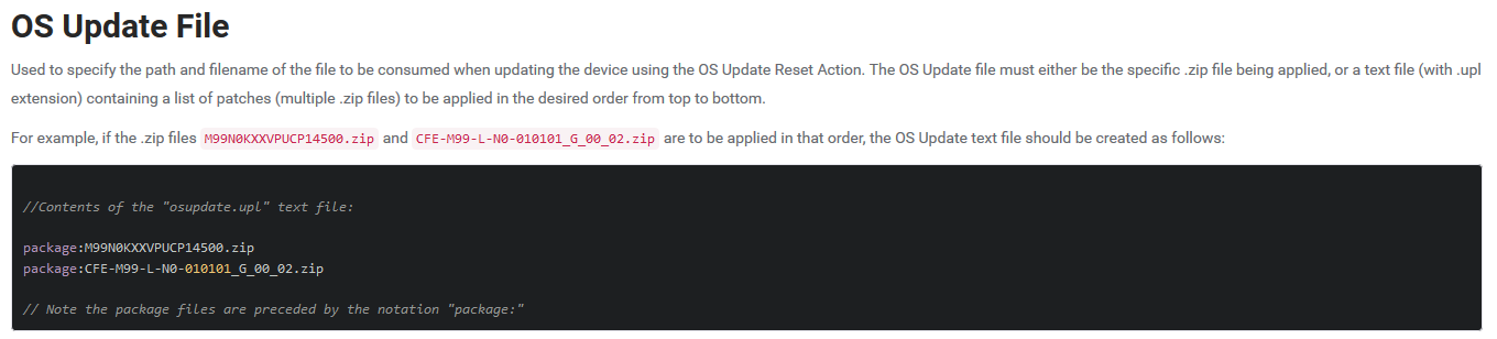

Based on ZEBRA Tech Docs for StageNow it should be possible to have 2 or more OS .zip files install "at the same time" by using an .upl file.
http://techdocs.zebra.com/stagenow/3-0/csp/power/

Zebra said this is a known issue when it comes to upgrading OS via .upl file.
I also tried it with a StageNow barcode and left MobiControl completely out of it and pretty much got the same error or outcome --> only BSP gets installed and not the LifeGuard patches afterwards
