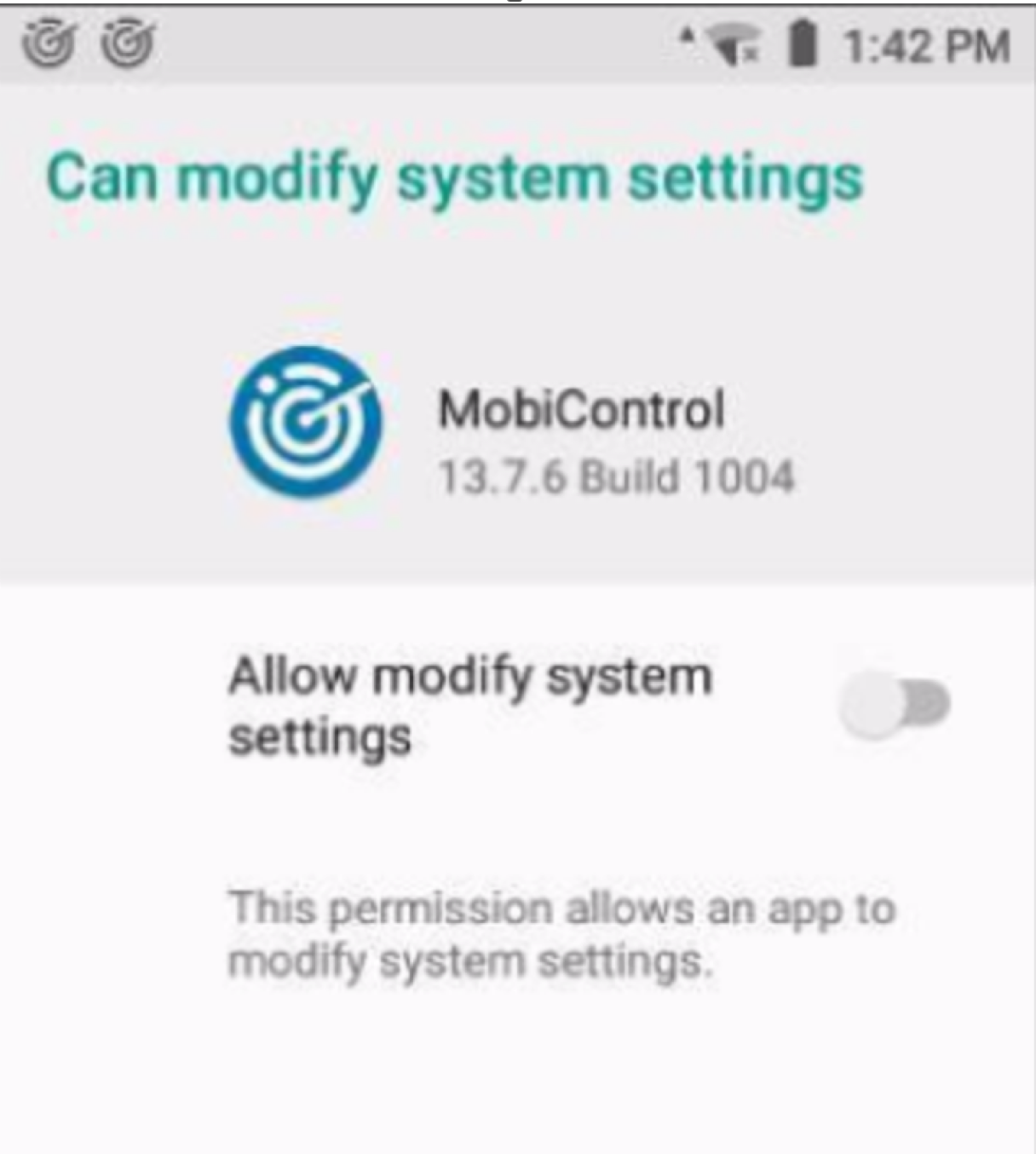

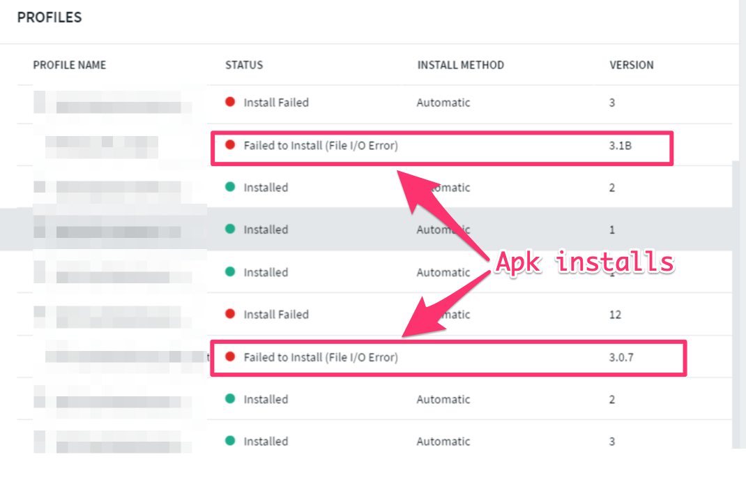

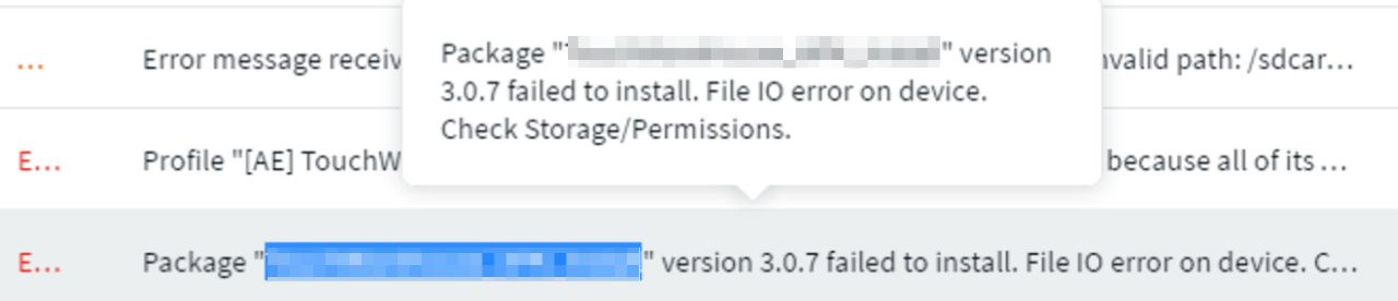

I have a 14.2.3.1069 instance with Zebra MC93s enrolling with AEDO via StageNow on agent version 13.7.6 Build 1004. The devices are running the latest public Oreo BSP from Zebra (01-21-18.00-OG-U00-STD) for the Helios devices and have the Zebra OEM Plugin (Zebra_Hawkeye_RC_AE_1.6.0.102) installed. On just about 1 out of 3 of the devices I enroll I get a prompt to manually enable the modify system settings permission. The other devices never prompt for this and install all packages and profiles without issue. The devices that prompt for this actually fail to install any packages containing APKs, citing storage/permission issues. After granting the permission manually and then forcing a package reinstallation the installation is successful. Any idea on what might be going on here?
