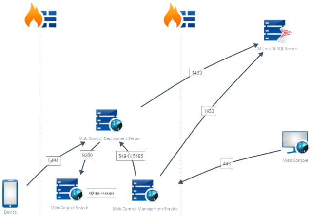

We are surprised that we do not know about this flow since it does not appear on the network config diagram:

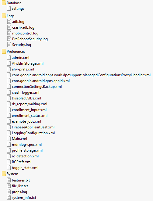

The debug report ZIP file contains system information about the device, various device and agent logs, the agent’s internal database, the agent’s internal shared preferences files, the assets related to lockdown kiosk configuration, and some other miscellaneous contents of the agent’s private internal storage.
