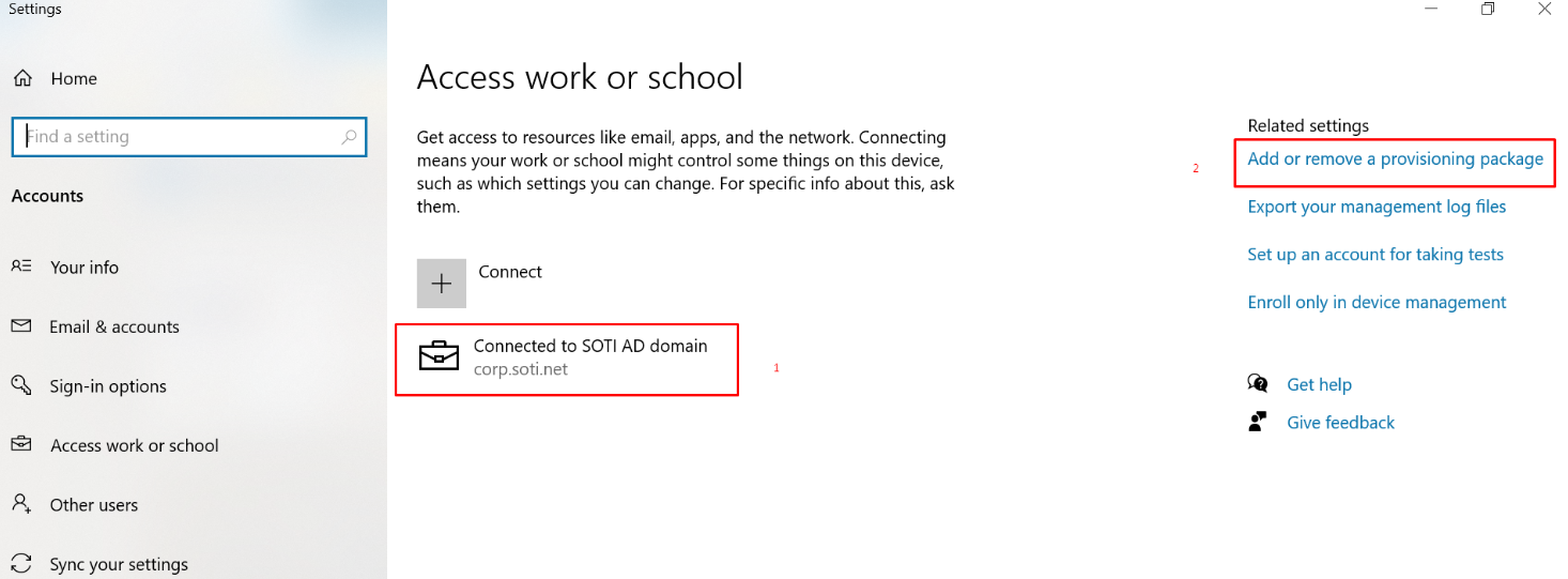

As Michael suggested that in order to unenroll the Windows Modern device, we have to remove the provisioning package from the device. Please follow the steps below.
(1) Navigate to Settings> Accounts > Access work or school > Add or remove a provisioning package and click it and press remove.
(2) Uninstall MobiControl agent from the Control panel.
(3) Remove SOTI folder from C:\Programdata or from C:\Program File (x86), if not there check in C:\Program File.
(4) On the web console, select Device action > 'Delete'
Please find the attached screenshot below.
