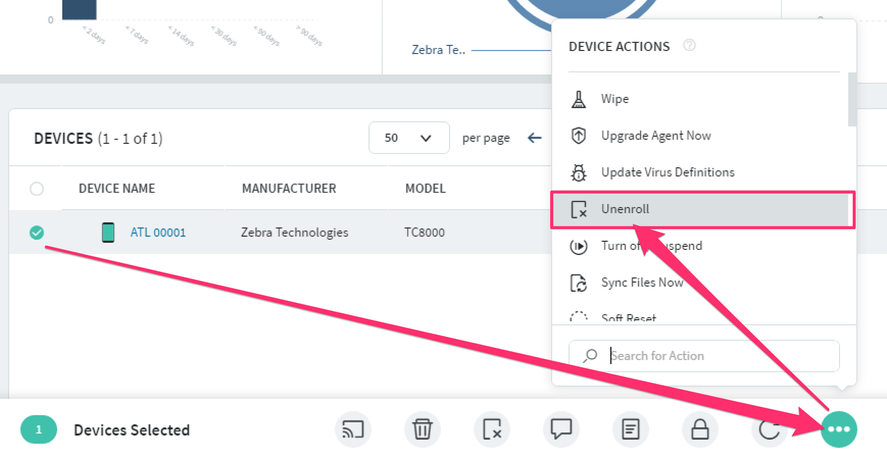

Are you deleting the device from the Inventory or un-enrolling it? I would suggest maybe un-enrolling it instead and revoking the certificate before deleting it.

i can't find the un-enroll action in Soti 14.0

hi Matt,
thank you for your fast response.
i don't have this option in the action screen.
