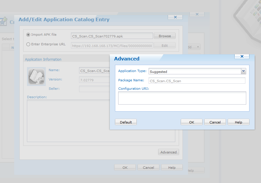

How could it set the restriction by MobiControl ?
May you post some screencaptures from MC console to clarify it.

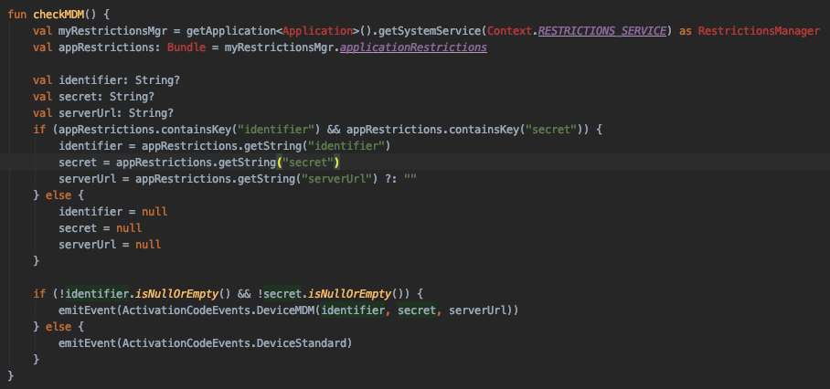

I need to set some values to the app as shown in code below, but could not identify how to set it on catalog rule or package .
