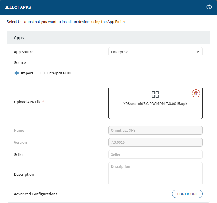

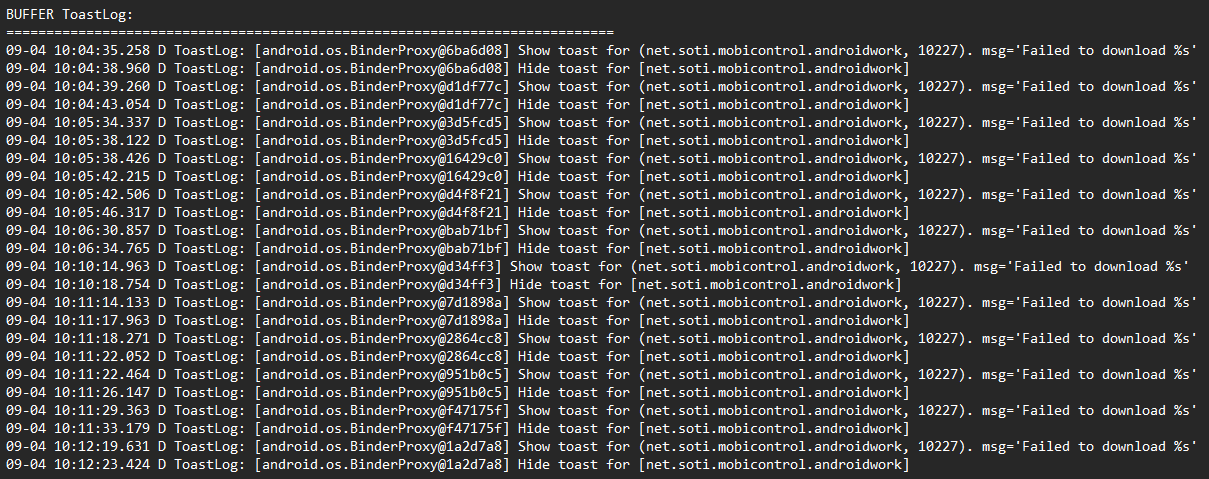

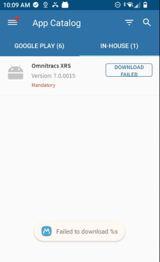

Recently we have had a number of issues installing the Omnitracs XRS application on our TC57 Android 13 devices. Back in July, we were forced to go to package-based deployment of the app due to a weird error when deploying it using the built in App Policy method (Enterprise APK upload). I have attached screenshots showcasing this issue as well as the device logs.

1. Is there any way to get the App Policy to work again or is this a known issue? This doesn't seem to be an issue with Google as the device is clearly showing an error even when attempting to install it.
