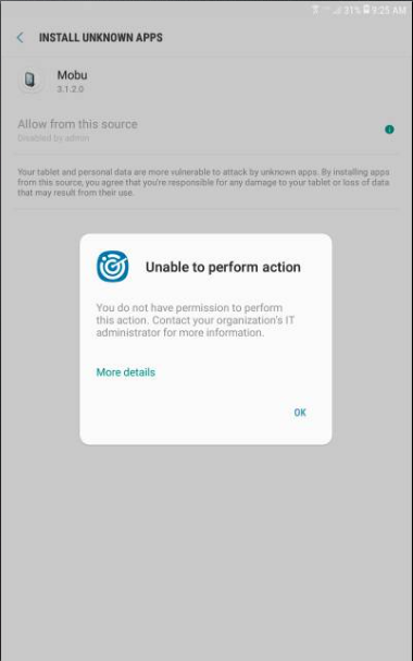

hello, i have two samsung devices enrolled with enterprise and for some reason when i am in the kiosk mode and enter the admin password to unlock the device, i try to allow installs from unknown sources, and it does not let me. i get a message that says please contact your IT administrator. however, when i send "notify kiosk off" script, i am allowed to change it. is there any way i can have it to always allow unknown sources?

thank you for the reply!- unfortunately i have tried this and still get the error even after entering the admin password. i have found that running the "notify kiosk off" screen allows me to change it. but even once changed, when i try to update my app, i get the sane error. i have attached a screenshot.

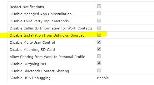

Since the devices are enrolled as Android Enterprise, could you please confirm if a Profile with Feature Control "Disable Installation from Unknown Sources" has been assigned?

i have checked and made sure that feature was not causing the issue. it is not checked. but still has the same issue

the tablets we are using are SM-T378V Samsung Tab E with Verizon. what we do is we package up an apk for our "mobile updater app." from there we download the app our company uses. although with enterprise, it will not let us download/update because the mobile updater app is an "unknown source". i would love to begin a remote session with one of you so you can get a better idea of what is going on. in order to deploy these tablets to field user employees, we will need to figure out a resolution. i really appreciate everyone's time. look forward to hearing from you.
