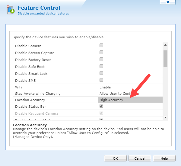

Hi Glen
Did you try this?
This works for my devices (Zebra TC56).

Currently using Mobicontrol v14.1 and this is what i see for android plus devices.
I have tested the enforce GPS setting and it looks like it does work and turns it on, but a profile has to be created and assigned to the phone or a group. I was hoping to avoid making too many unnecessary groups and profiles as we manage over 1700 devices and there already too many.
Also didnt want to have this constantly on as this does drain the battery on users devices.
