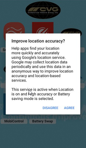

I am trying to get location services set up on my TC70x devices. They are running Android 8.1.0 with Android Enterprise. I have set Location Accuracy to Battery Saver in Feature Control. After I deployed this to my test devices I got this pop-up:
On one device I clicked "Agree" and the location tab SOTI was able to immediately locate the device. On another device I did not click anything, and later clicked Disagree and for both SOTI was unable to locate the device.
Is there a way for me to turn on this setting remotely with a script or something? I cannot rely on users to click Agree on all the devices.

You are seeing this because, the Google Location Services on the device is not toggled on. To simplify it, Go to device settings, type "Location", look for "Google location services".
Once you toggle it on you wont see this pop-up.
This will solve your issue.

Having to go to device settings and turn this on manually is my whole issue. I have devices in plants all around North America and these plants do not have IT people or anyone to do this manually. My post was asking how to do this with a script or something.

Please try using "High Accuracy" in Location Accuracy in Feature Control.

Turning on High Accuracy will result in a different but similarly problematic dialog that grinds things to a halt until dismissed.  Zebra provided me an apk that enabled high accuracy and then silently dismissed the resulting Google dialog, resolving the issue for me.  I'm not sure if I'm allowed to publish it as there might have been some legal "you agree to this" stuff.  I can't remember.  You might just get in contact with your Zebra SE and see if they can give it to you.
