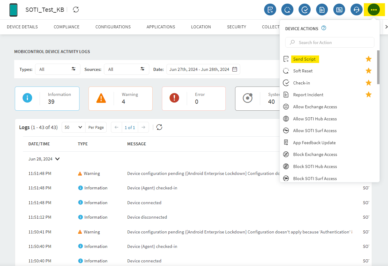

1. In the web console, navigate to Devices.
2. From the Devices page, find the enrolled device with an offline status. This indicates the SOTI MobiControl Device Agent is disconnected. The device should have network connectivity.
3 From the the offline device's Device Actions, select the Send Script option as shown in below :
Send script device action

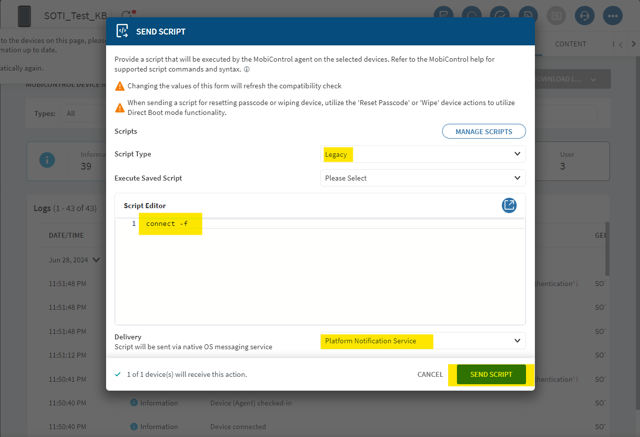

4 .For Script Type, select Legacy.
5. For Script Editor, enter connect -f
6. For Delivery, select Platform Notification Service.
Script editor with script in it
7. Select Send Script.
Note: Once the script is executed, the device will be back online as the device's SOTI MobiControl Agent will be reconnected.
