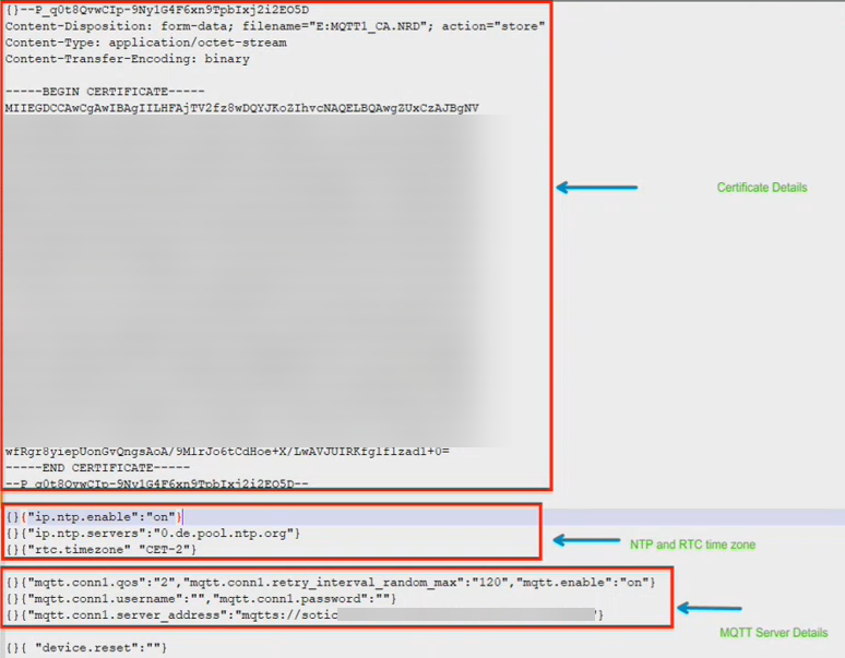

1. Create the .ZPL firmware file containing the MQTT server settings. Learn more about creating these configuration files in this SOTI Pulse article.

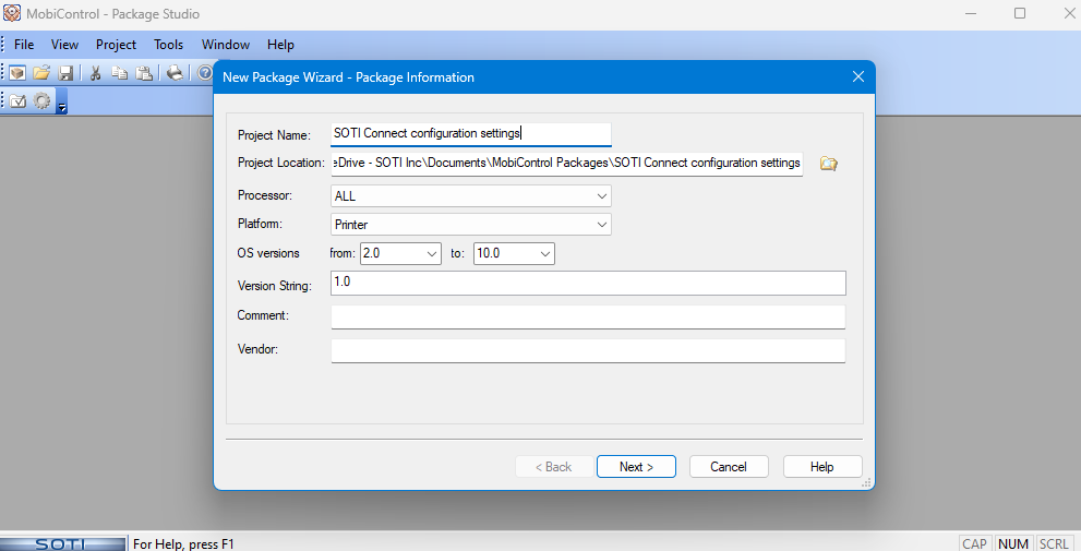

2. Open the MobiControl Package Studio application and create a new printer package.

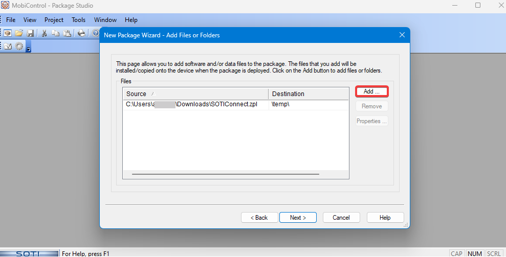

3. Add the configuration file and proceed to build the package.

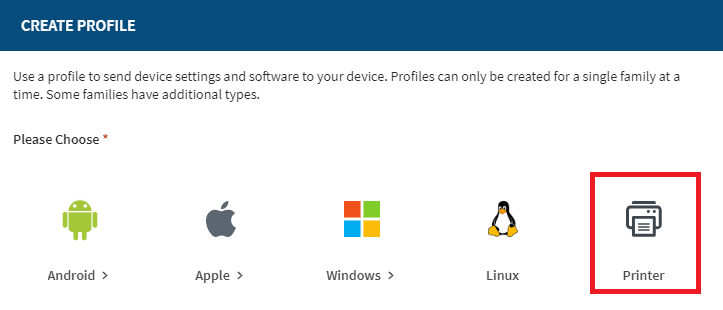

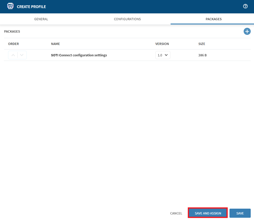

4. On the SOTI MobiControl web console, create a new Printer profile.

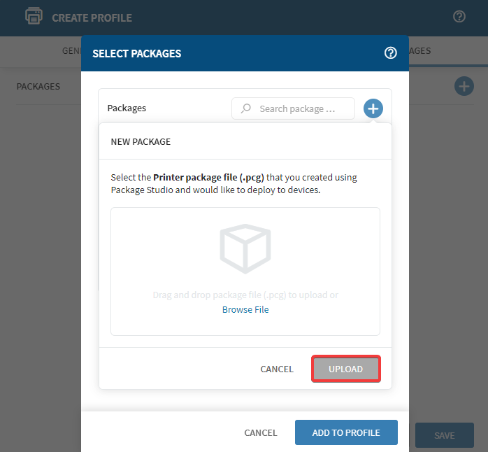

5. Upload the built package onto the profile.
6. Save and assign the profile to the targeted printers.

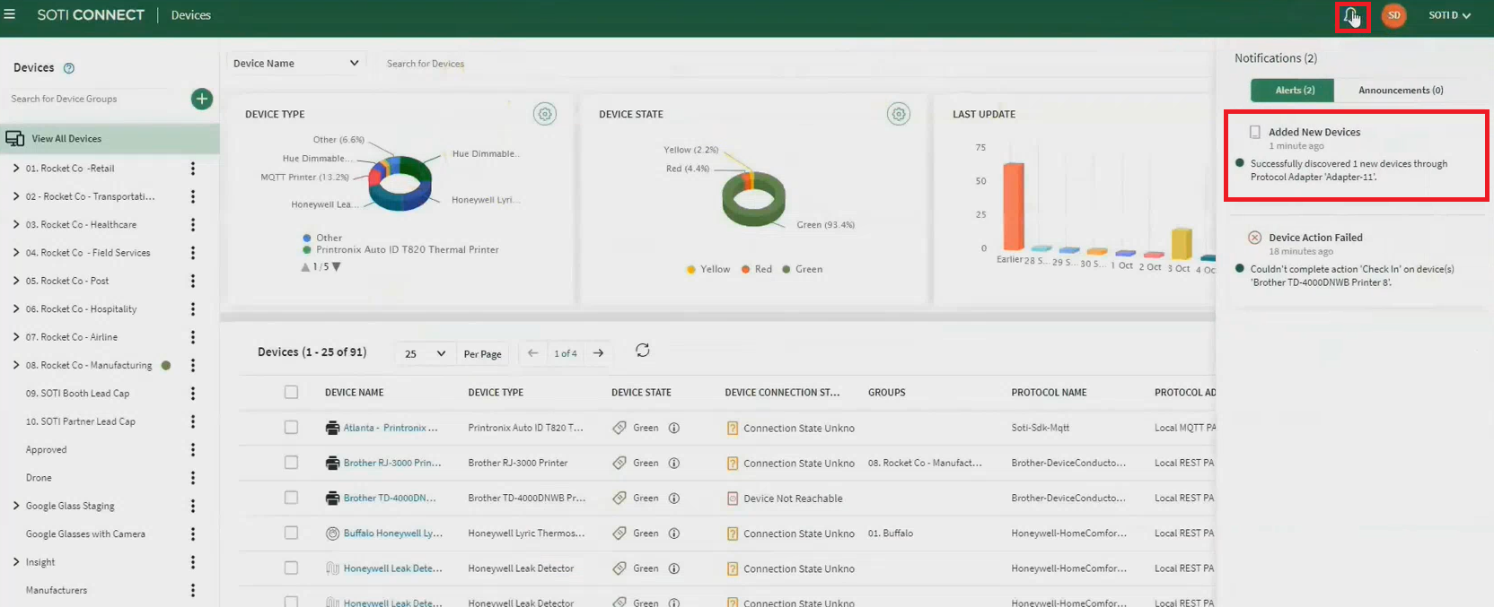

Once the printer receives the configurations and establishes communication with the MQTT Broker, an alert indicating a printer was discovered appears on the SOTI Connect web console. Follow these steps to approve the discovered printers and complete enrollment:
1. On the SOTI Connect web console, select Alerts to view the discovered device alert. Note: Zebra devices are auto-discovered as they are MQTT-RPC devices.
2. To enroll the printer, select the device that is waiting for approval and choose Approve.
Note: You can also create an enrollment rule to approve devices that you discover automatically.
