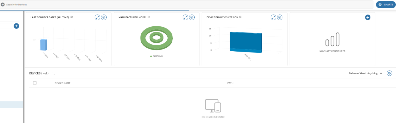

Device Group not loading

After an upgrade, some properties used in device group column views may no longer be indexed for search. When the Web Console queries these properties, the search request fails because the properties are no longer searchable, preventing the affected device groups from loading.
