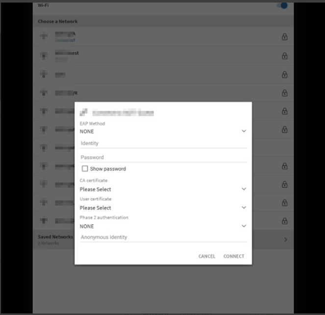

When using a Wi-Fi profile alongside Settings Manager on Android Classic devices, an issue arises upon device reboot. The Settings Manager fails to recognize a backup network as a saved network with a valid password, leading to credential prompts. Despite the network being saved in Android settings, it is not recognized by the Settings Manager.

  • Attempting to connect to a secondary network deployed via a Wi-Fi profile results in the Settings Manager not recognizing it as a saved network after device reboot.
  • Connecting to the Wi-Fi network through Android Settings works correctly, but not through Settings Manager.
  • The user may be prompted for security credentials that do not match the Wi-Fi protocol (for example: incorrectly assigning user and password for non-enterprise Wi-Fi).
    Image of Settings Manager prompting for password on a saved Wi-Fi network

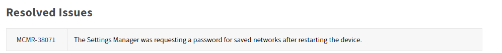

To prevent this issue, ensure that the Settings Manager version is upgraded to 2024.1.2 or above before deploying Wi-Fi profiles.
Issue Resolution
Upgrade the Settings Manager version to 2024.1.2 or above. For release notes and updates, please visit Settings Manager Release Notes.
Image showing ticket fixed in Settings Manager version 2024.1.2
