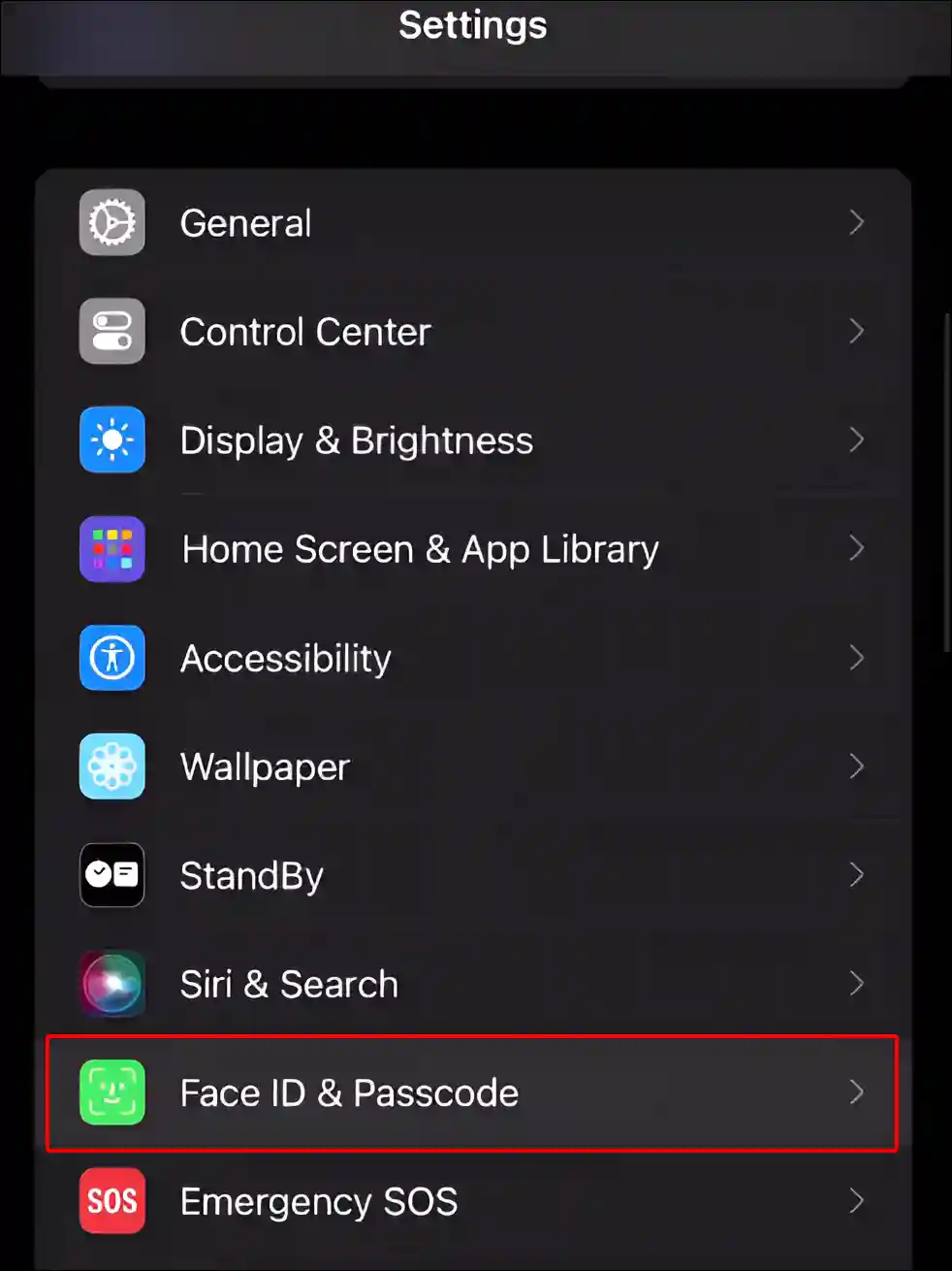

1. Navigate to Settings then do one of the following:
  • On an iPhone with Face ID: tap Face ID & Passcode then enter your passcode.
  • On an iPhone with a Home button: tap Touch ID & Passcode then enter your passcode.
The Settings panel showing Face ID & Passcode highlighted.

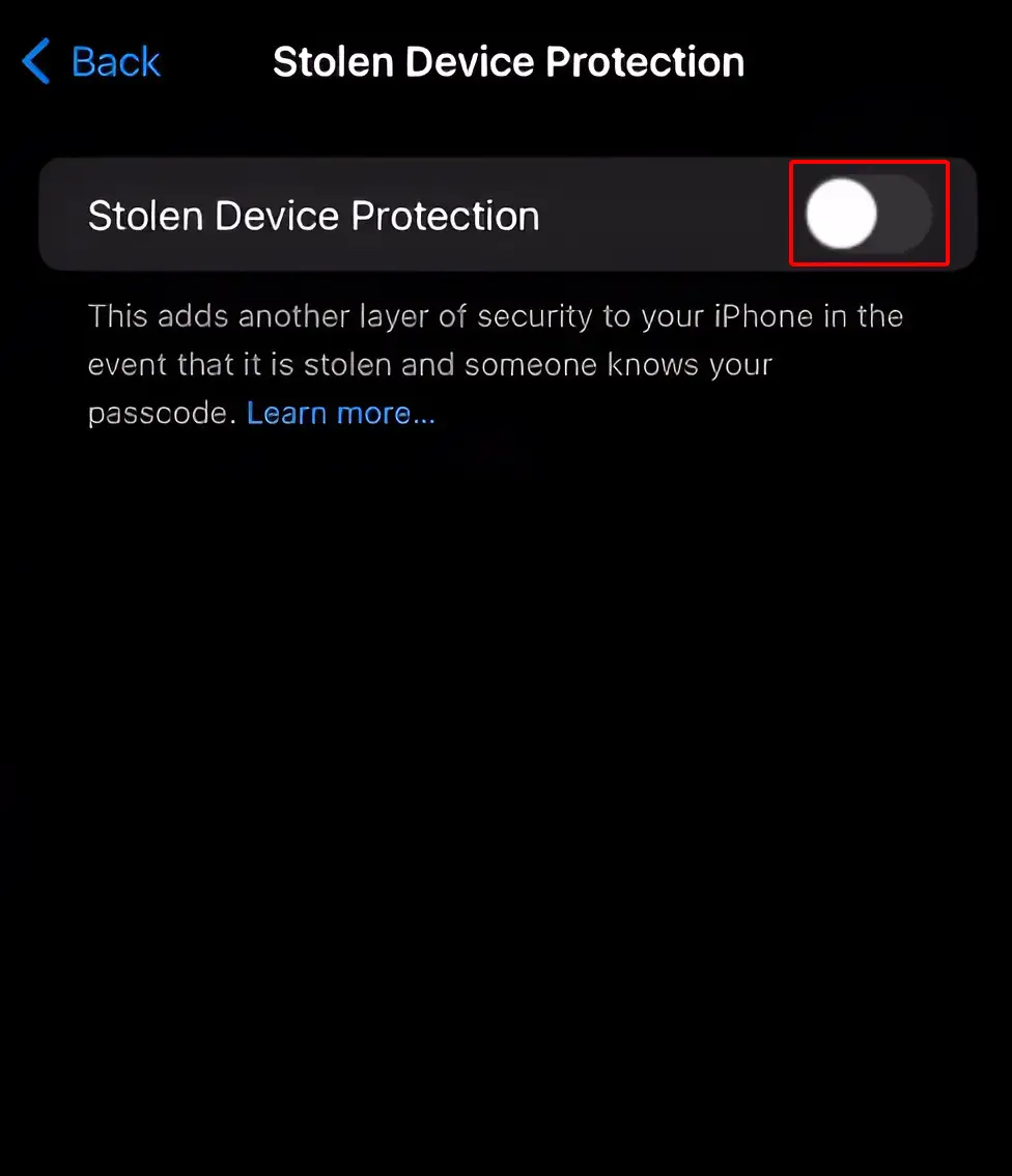

3. Turn Off Stolen Device Protection.
The Stolen Device Protection screen with the toggle option disabled
4. Wait for an hour and then retry enrollment for the device.
