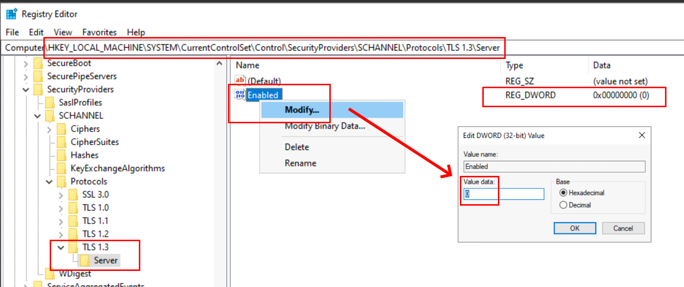

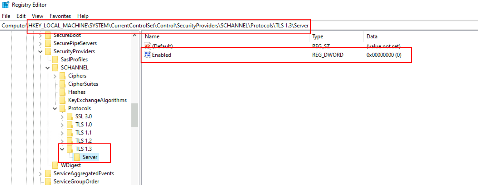

To disable TLS 1.3  on Windows Server 2022
1.  Run Registry Editor and go to the following registry:
HKEY_LOCAL_MACHINE\SYSTEM\CurrentControlSet\Control\SecurityProviders\SCHANNEL\Protocols\TLS 1.3\Server
2. Right-click on Enabled to open the menu.
3. Select Modify then Set 0 to:  DWORD (32-bit).
Note: 0 is disabled and 1 is enabled.

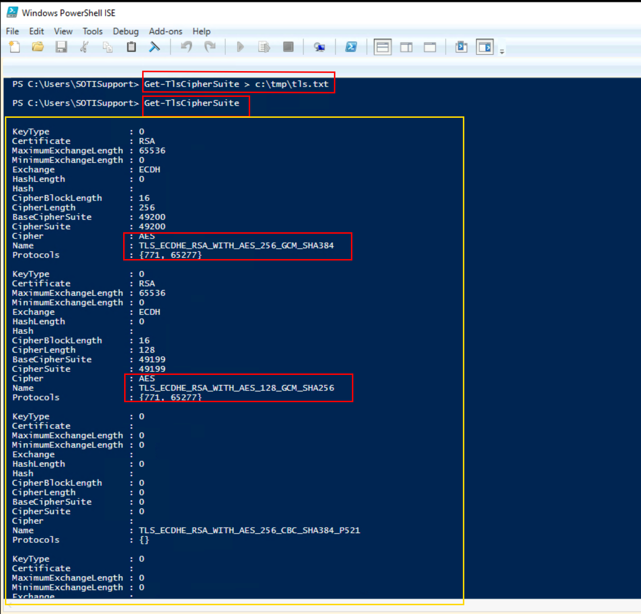

To verify if any of the required cipher suites are enabled for APNS:
 1. Run the Powershell command "Get-TlsCipherSuite" and verify if any of above cipher suites are in the output.  Example of the output is in Yellow in the screenshot below.
 2. If the output is large, redirect it to a temporary file (e.g., c:\tmp\tls.txt) then verify it by using a text editor.
