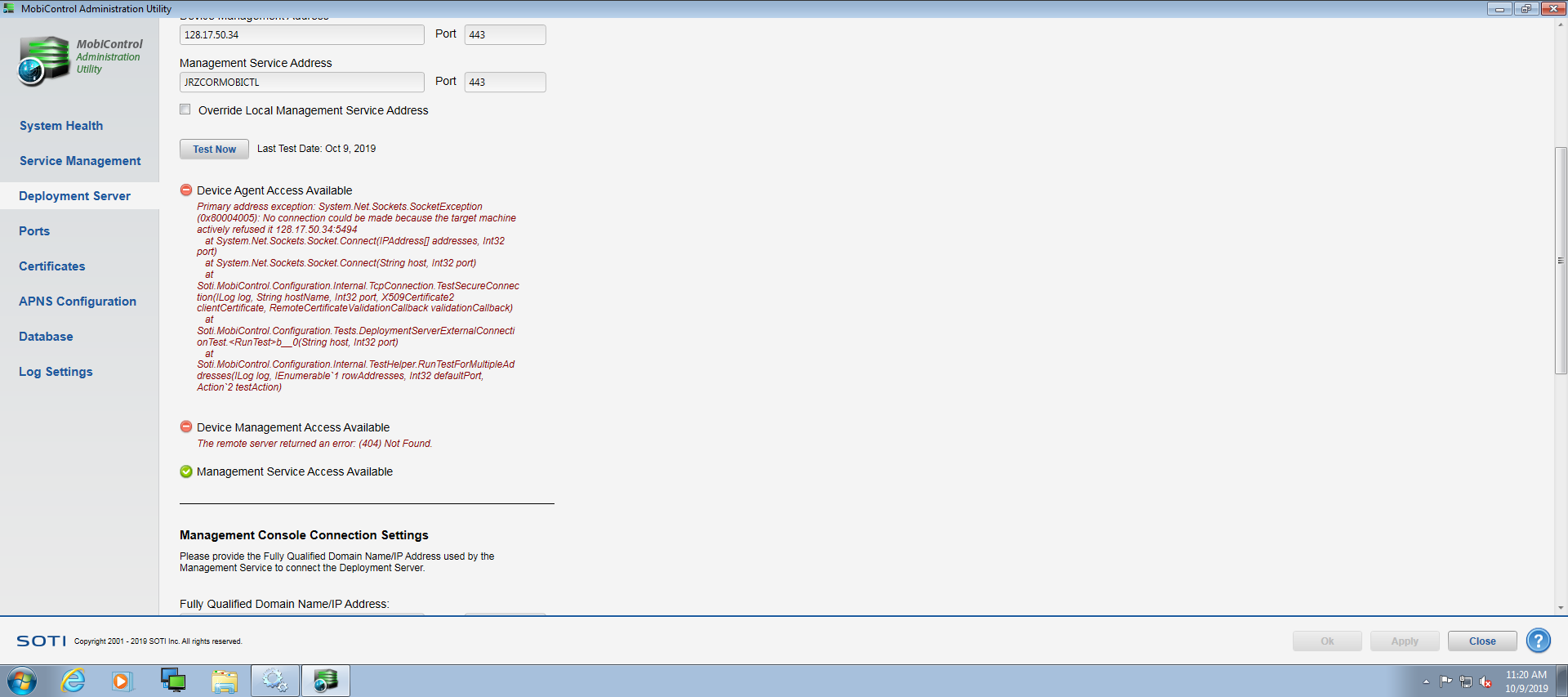

Hi, I installed SOTI v13.4, I am getting Target Machine Actively Refuse.
If you install your v13.4 from scratch rather than upgrading from a functional previous version,  I believe you probably have incorrectly configured your server with MCadmin or  your network infrastructure/firewall.   In such case, it' better for you to open an official support ticket with Soti to debug your case in more details.
If you upgrade from a functional previous version, you can fallback by restoring a backup image. Maybe you can explore if you should try upgrading to a different v13.4 build, or even to a v14.x version.

hi, sorry but I missed say that is an update not a fresh installation, currently I have installed SOTI v13.3.0.3116 and it is working correctly.
Did you change any parameter(s) or certificate(s) with MCadmin utility?
With what platform of devices did you experience problems?   What are the brands/models and the device firmware versions?
What are the version and build numbers of the device agents on your problematic devices?

Version:1.0 StartHTML:000000248 EndHTML:000002275 StartFragment:000001998 EndFragment:000002202 StartSelection:000001998 EndSelection:000002202 SourceURL:https://discussions.soti.net/thread/deployment-server-error-after-install-soti-v13-4/Deployment Server Error after install SOTI v13.4
Hi Raymond, Chan, the issue is in MCadmin, the services don't run so the devices can't be updated..

Hi Luis,
Did you log in as Administrator of Windows Server and run the MobiControl installation executable as Administrator?
Your limited screenshot showed that you use IP address as the device management address.  This is OK in the past, but there are more problems when used to control devices on recent versions of device platforms such as Android Enterprise, iOS13+ and Windows Modern.   I'm also suspecting that there can also be problems with your certificates set-up.
