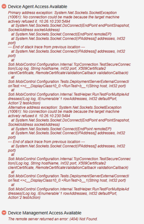

I have migrated our SOTI Dbs (MobiControlDB, MobiControlDB_Archive, MobiControlDB_Signal, SotiAssist) from one dedicated DB-server to another DB-server. All on-prem.
Old SQL: 2019
New SQL: 2022
The problem now is that the "Mobicontrol Deployment Service" does not run properly. All other services are running smoothly. I can access the web console but I do not get any contact with any device. I have already ruled out any port errors. Everything works good again if I switch back to the old DB-server.

Based on the screenshots from the MobiControl Admin Utility and the SOTI Pulse dashboard, the errors indicate that the system is still attempting to connect to the old Deployment Server IP (10.26.10.230) on port 5944, also the port 5494 is the one for the deployment server you can try. Which is now inactive following your SQL Server migration to a new dedicated DB server (SQL 2022).
The exception SocketException (10061) means the connection is being actively refused, most likely because the Deployment Server is no longer listening on that IP, or the IP reference was not updated post-migration.

The deployment server is separate from the DB server and has not changed. The only change is the DB server.
Services has been restarted already with the same error.
The tables you are referring to, which database are they inside? I cannot find them in any of my Mobicontrol DBs.
