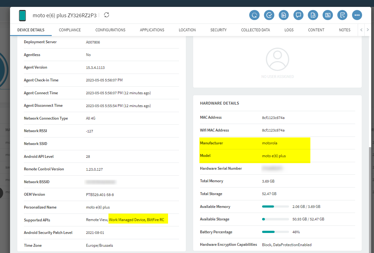

i can't seem to get the Remote control on our Motorola devices

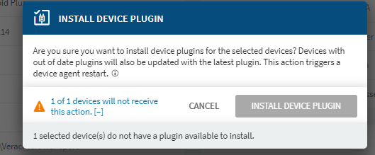

i checked to install the Motorola Plugin but when i try to install the plugin on the devices i get the message that there's nothing to install.

From the Supported API's field shown in your screenshot,  I reckon you can start remote view without problem.
As there is message saying there is no relevant plug-in for your device, there is virtually no chance that any new plug-in supporting RC can be installed onto your device. I do not have any Motorola E6 Plus device and therefore cannot check further, and I am not sure what BiltFire RC is.  Based on the name, it should be an API for supporting remote-control, though it MIGHT be incorrectly detected/enabled and might not be the right API for your device.  .  You might try running the script
  retryrcdetection
  restartagent
to see if the support API list get changed, after which RC session can be run successfully.
