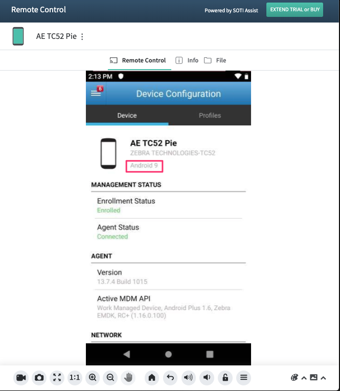

Not Samsung, but I can confirm that MobiControl is compatible with Android 9.0 and Remote Control on Zebra devices:
