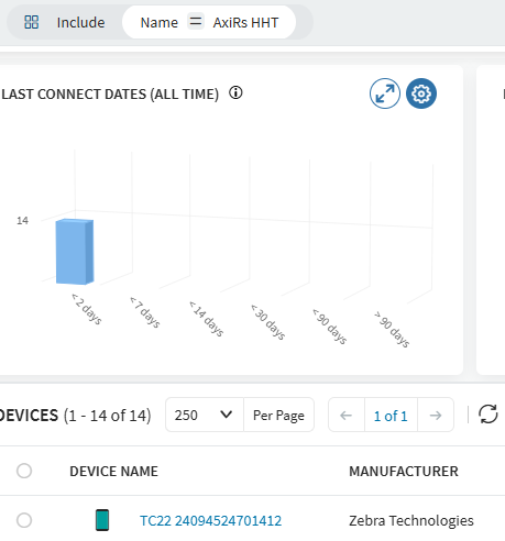

after pushing an application update it happens that a pda doesn't update. instead of manually going through all the pda's to verify the version number of the application i thought i'd use the search function in MobiControl if i search by application name i get all pda's with the application installed. but when i use:
name = appname  and version = 4.1.32 i no longer get any result back.
am i doing something wrong?

the app we're defining the search with is an app that's not available on the app store.
how i'm currenlty searching now is like this.
if i search just by the app name results will be shown. (all devices with the app)
but when i further define it with the version number, yes it's a long one but i've tried with shorter version numbers as well and i've tried = and starts with. no devices will be found

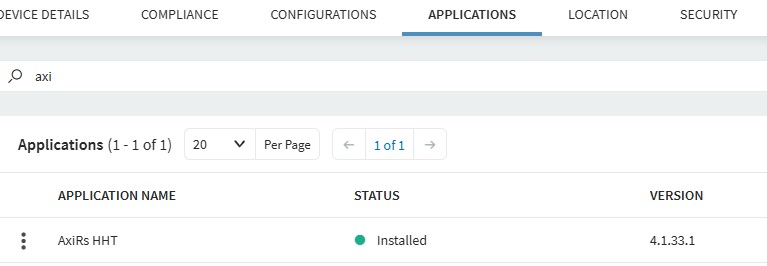

currenlty i've been manually checking each device after a week to see if they've been update by clicking on the device and going to application an seeing which version number it's at.

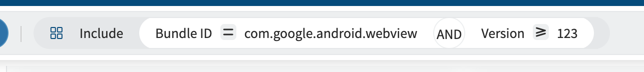

This is the search syntax I use:
a year ago
Have you changed the wordings in your initial post?   If I remember or interpreted correctly,  you got some devices listed when using your existing app name criterion in your filter expression.
Anyway,  as you clarified that your devices are Android devices, then using Bundle-ID of app is definitely much better (i.e. more precise way) to identify the correct app, just like the cases when building app blacklist/whitelist in MobiControl application-run-control profile policy.
For complex version number like 4.1.32i,  using operator such as > may not work.  You can try using the "start with" operator I mentioned in earlier post.
