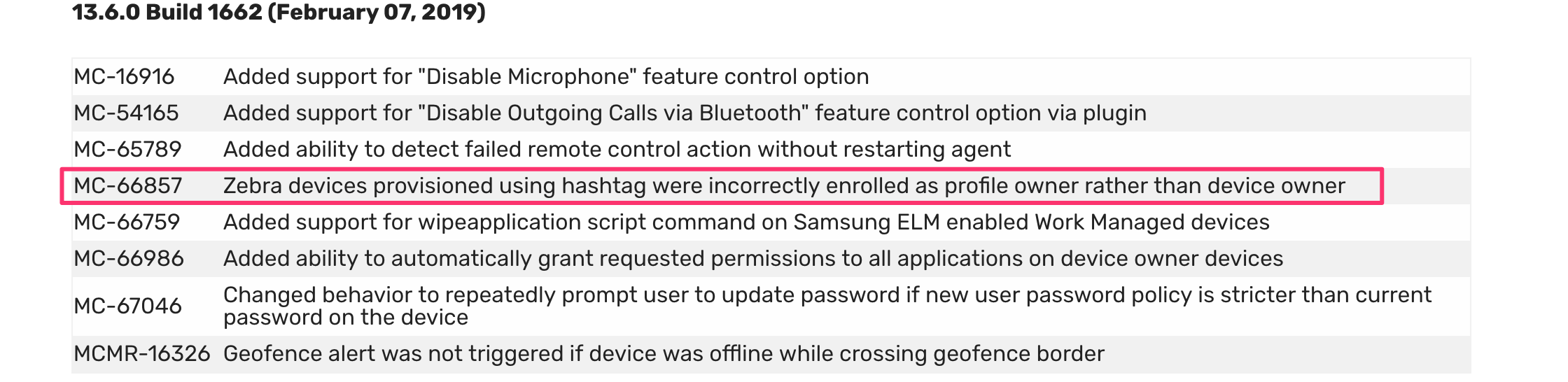

Now that I'm revisiting this thread I'm also seeing that Jim was running into a bug on the AE agent at the time. I ended up running into the issue myself and was very frustrated to not get the device enrolled as a Managed Device. Newer versions of the AE agent resolve this:

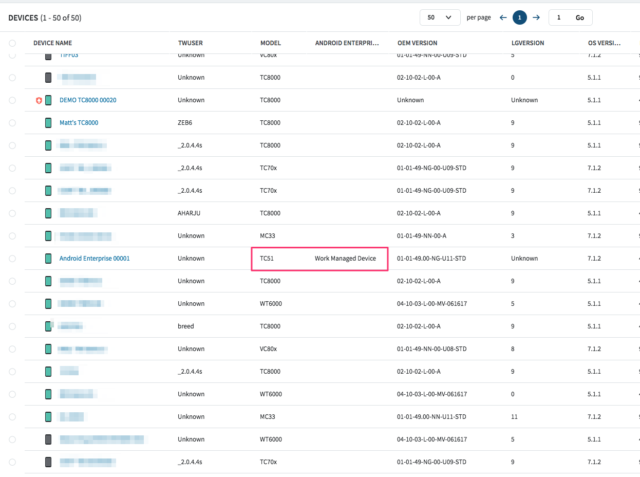

Factory Reset can be performed via StageNow based barcode scan and technically doesn't require a Factory Reset package although Zebra does publish them as .ZIP files that can be applied via recovery mode. I factory reset a GMS TC51 earlier today using this method. The device was enrolled via DA with the OEM specific agent previously and then I was able to enroll it back into the same SOTI instanced as a Fully Managed Device under DO with the afw#mobicontrol hashtag during the setup wizard.
