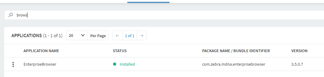

Hi Nicolò,
What do you see for a bundle ID for this browser, can you please confirm from Device > Applications > Search for the browser name, similar to below.
As I don't have that device as well, I can't test it by myself, but your bundle ID would be an issue. You may use com.rho.rhoelements instead of "com.rho.rhoelements/application " for the #Intent; section. Please let us know what you see above section, and then we'll do our best. I hope it helps. Thank you
Zafer
Hi Zafer,
bundle ID is correct
