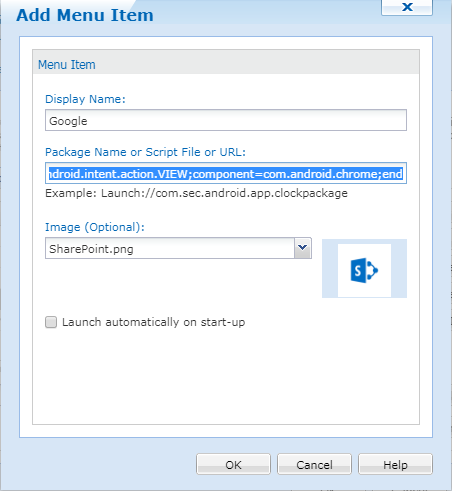

I would like to create a shortcut that will launch in Chrome when using a Lockdown/Kiosk profile.  Currently all URLs are launched using http:// and https:// and open in some sort of locked down Soti browser.
We are using a Zebra TC56 devices and have enrolled them using Android Enterprise.
Looking at previous threads with similar queries, a few others suggested using the 'Intent' command however we can't seem to get this to work.
For example, we have attempted using this:
Intent:http://www.google.co.uk#Intent;scheme=http;action=android.intent.action.VIEW;component=com.android.chrome;end
When we attempt to launch the shortcut, nothing happens.
Can you suggest any alternative options on how to achieve this?

The browser that opens when using browser:// and browsers:// is not Chrome.  I would like to find a way of defaulting the browser to Chrome when launching the URLs.

Please try something like
 intent://www.youtube.com#Intent;scheme=http;action=android.intent.action.VIEW;component=com.android.chrome/com.android.chrome.Main;end
Just replace "www.youtube.com" with the actual target URL you want to browse to.

Hi Edwyn,
Unfortunately not.  We ended up just using the browser: and browsers: to open the default browser in the end.
I would be interested to hear if anyone else has managed to achieve this.

Hi note sure if this helps but in Soti lockdown you can use the Launch://com.adroid.chrome i have not yet worked out how to lock this to specific URLs
