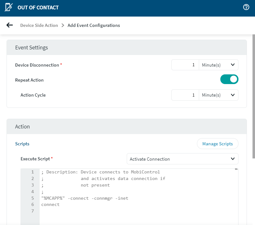

As a workaround, you can implement an Out Of Contact policy so the device attempts to reconnect after a period of time. Please see the screenshot below:

I have set in connection setting for reconnect on 10 seconds and it has improved. The main issue is the server start to enlarge its queue length, because of too much reconnections that are not caused by end user request.
That worked fine. Tks, JN
